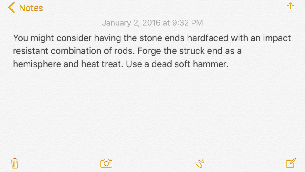

Stephen Spivey Posted January 3, 2016 Author Share Posted January 3, 2016 One of the rules is the steels cannot be hard faced. Quote Link to comment Share on other sites More sharing options...
