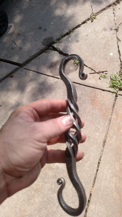

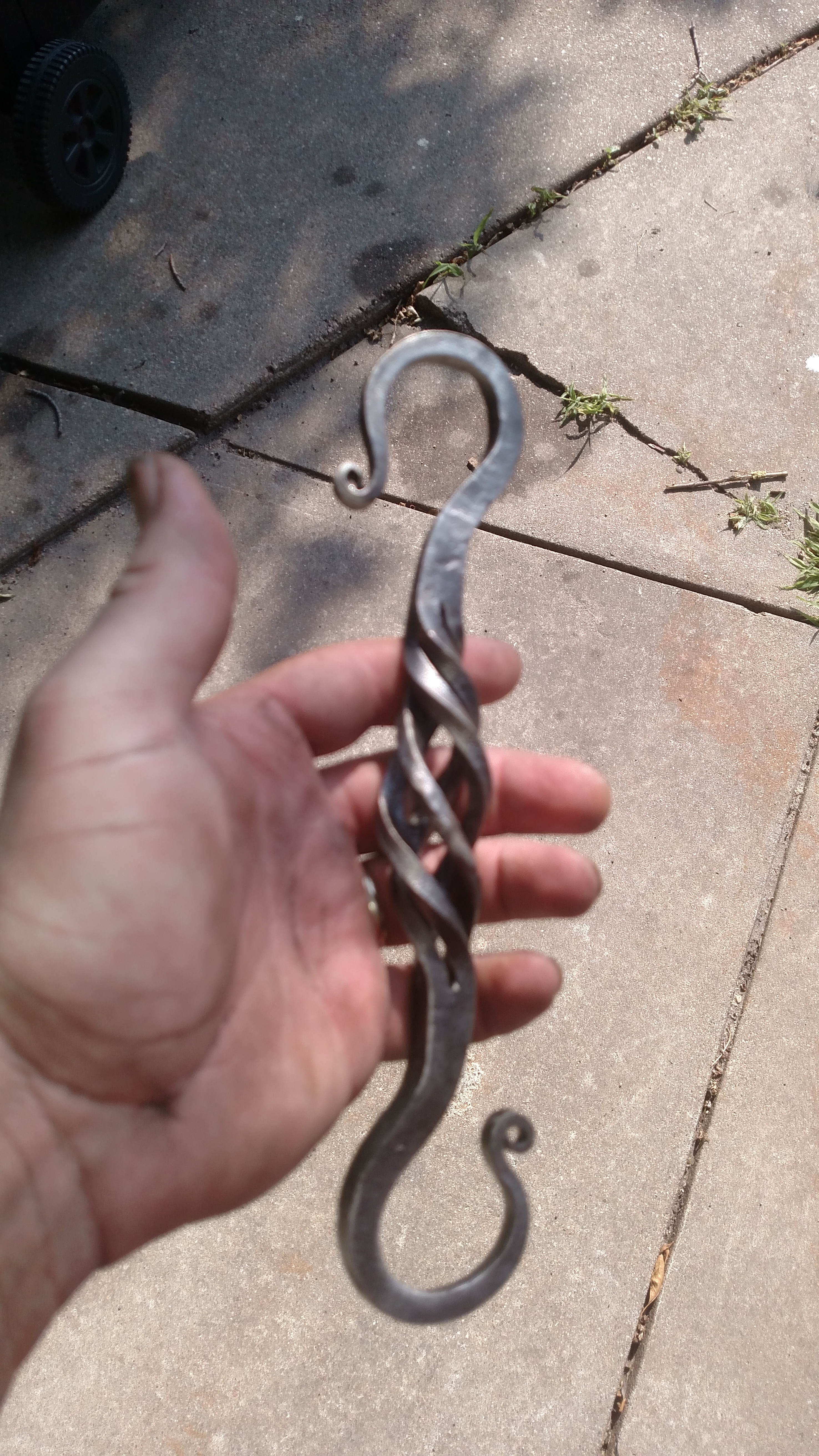

Donniev Posted June 20, 2016 Share Posted June 20, 2016 Thanks Michael that's awesome! Tried the basket twist again today, for some reason I fought it a LOT more than the previous one. Think next time I'll attempt to weld the spirals together like you guys have mentioned. A few pics from today's try, first one is next to another spike I've welded the back into itself. Daswulf I also tried to copy technicusjoes bolt tongs from Rr spikes, mine aren't pretty, but they work great! Quote Link to comment Share on other sites More sharing options...
Mark Ling Posted June 20, 2016 Share Posted June 20, 2016 one thing about the tongs that you probably all ready know, but ill mention it anyways, is that the set down closest to the reins Is in the wrong direction. other that that they look great! better that my first pair from rail spikes! Littleblacksmith Quote Link to comment Share on other sites More sharing options...
Daswulf Posted June 20, 2016 Share Posted June 20, 2016 Better then my first try as well. I only made the flat jaw tongs. Out of 3 pair, I use the second 2 a lot. First pair is hanging up somewhere reminding me what Not to do Quote Link to comment Share on other sites More sharing options...
Mark Ling Posted June 20, 2016 Share Posted June 20, 2016 10 minutes ago, Daswulf said: Better then my first try as well. I only made the flat jaw tongs. Out of 3 pair, I use the second 2 a lot. First pair is hanging up somewhere reminding me what Not to do my first ones were a fail, second ones were bolt jaw, and pretty close to a failed attempt but did use them a lot, and third was flat nip tongs to hold 1/4 inch round that I'm kind of satisfied with. Littleblacksmith Quote Link to comment Share on other sites More sharing options...

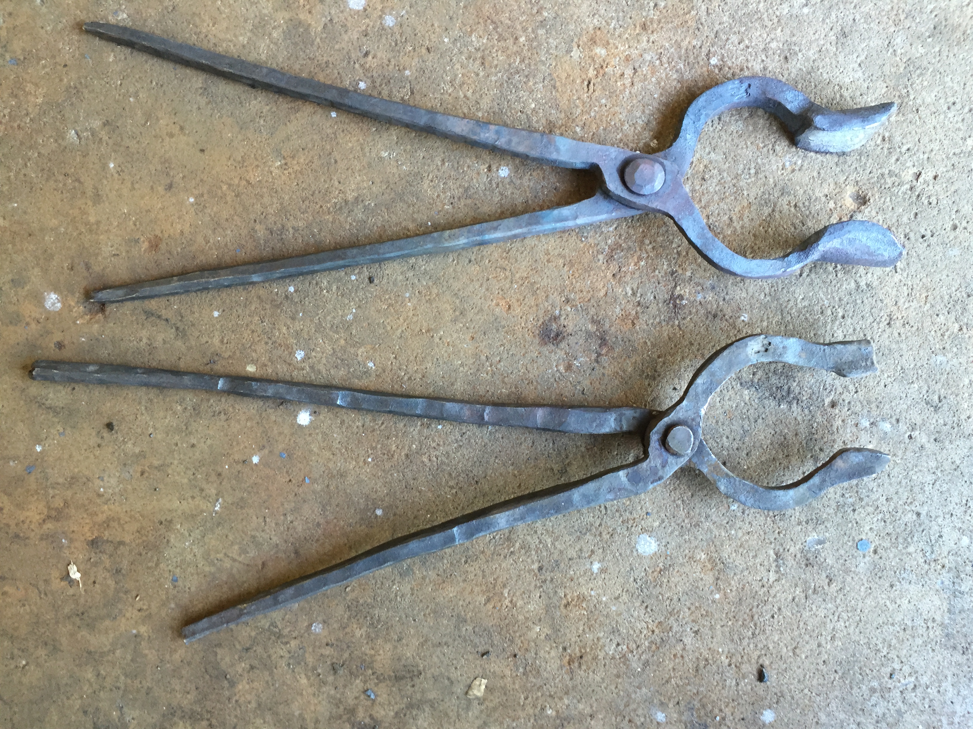

JHCC Posted September 6, 2016 Share Posted September 6, 2016 Two pairs of tongs: the bottom was my first pair, sized to hold rail spikes. I used them to hold the spikes to make the top pair, sized to hold torsion bar. Quote Link to comment Share on other sites More sharing options...
