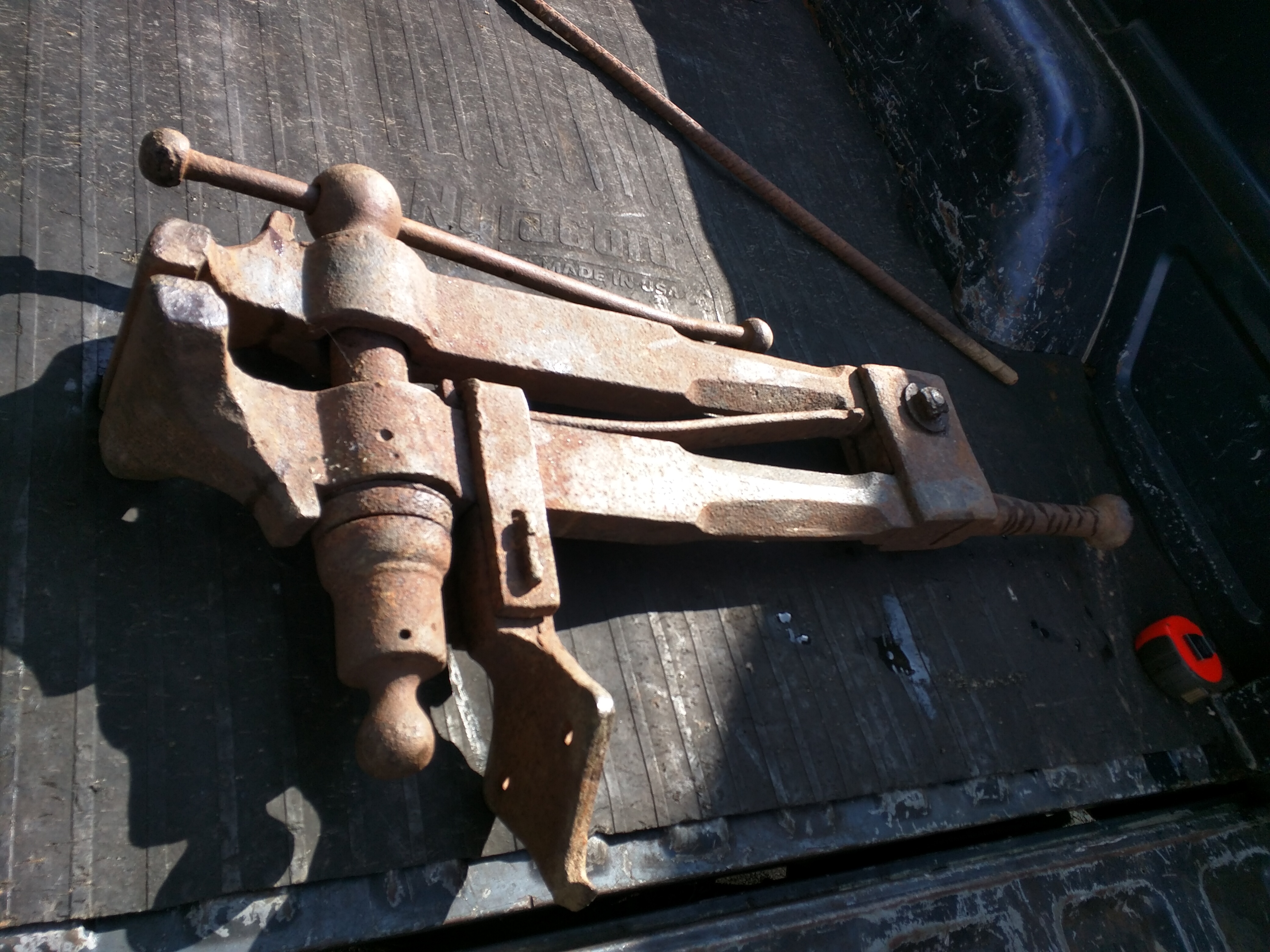

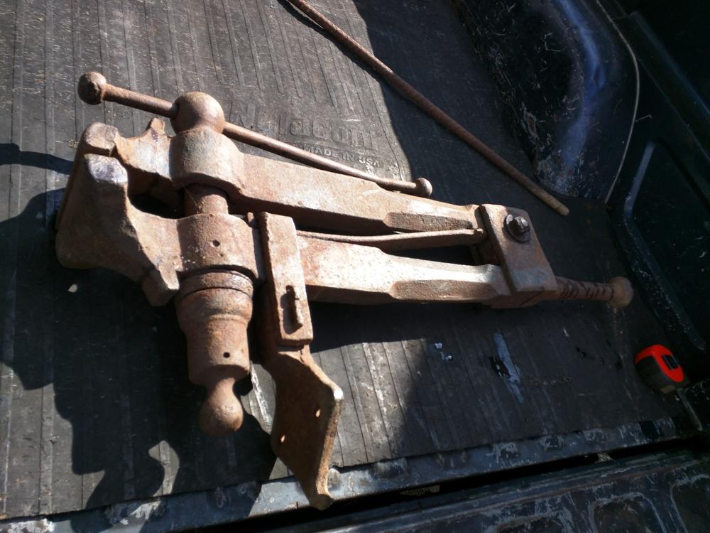

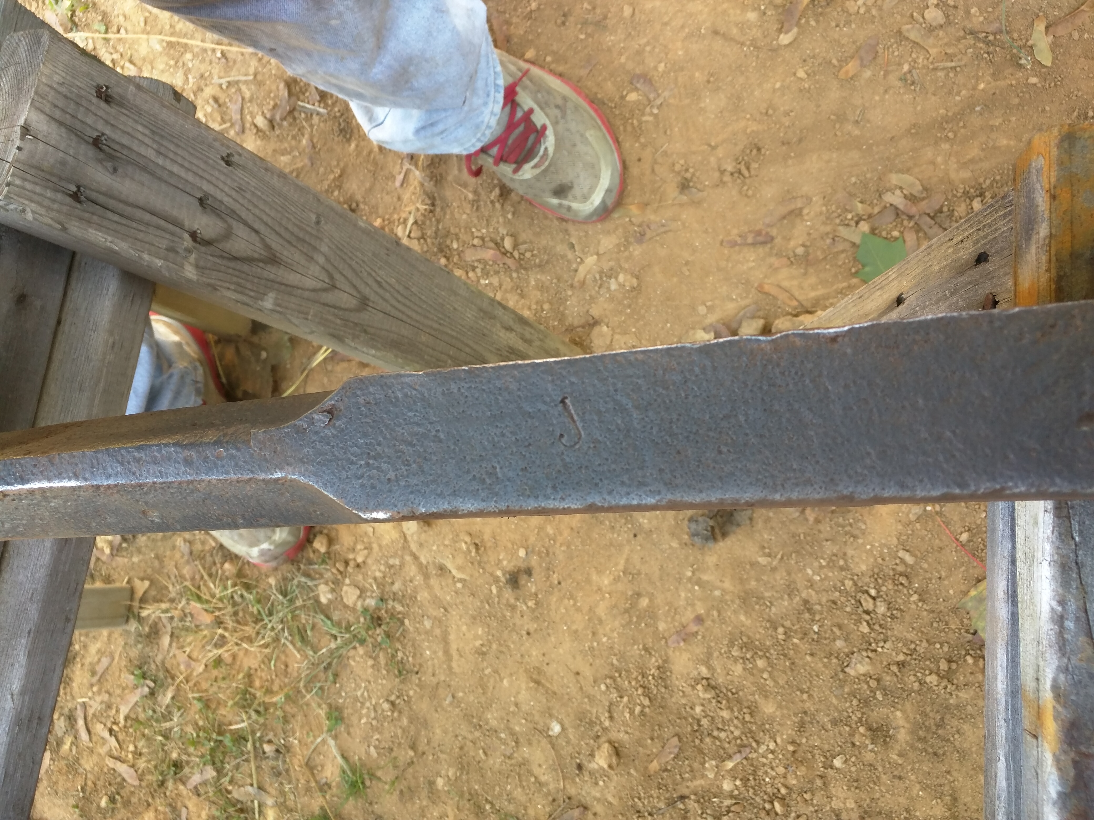

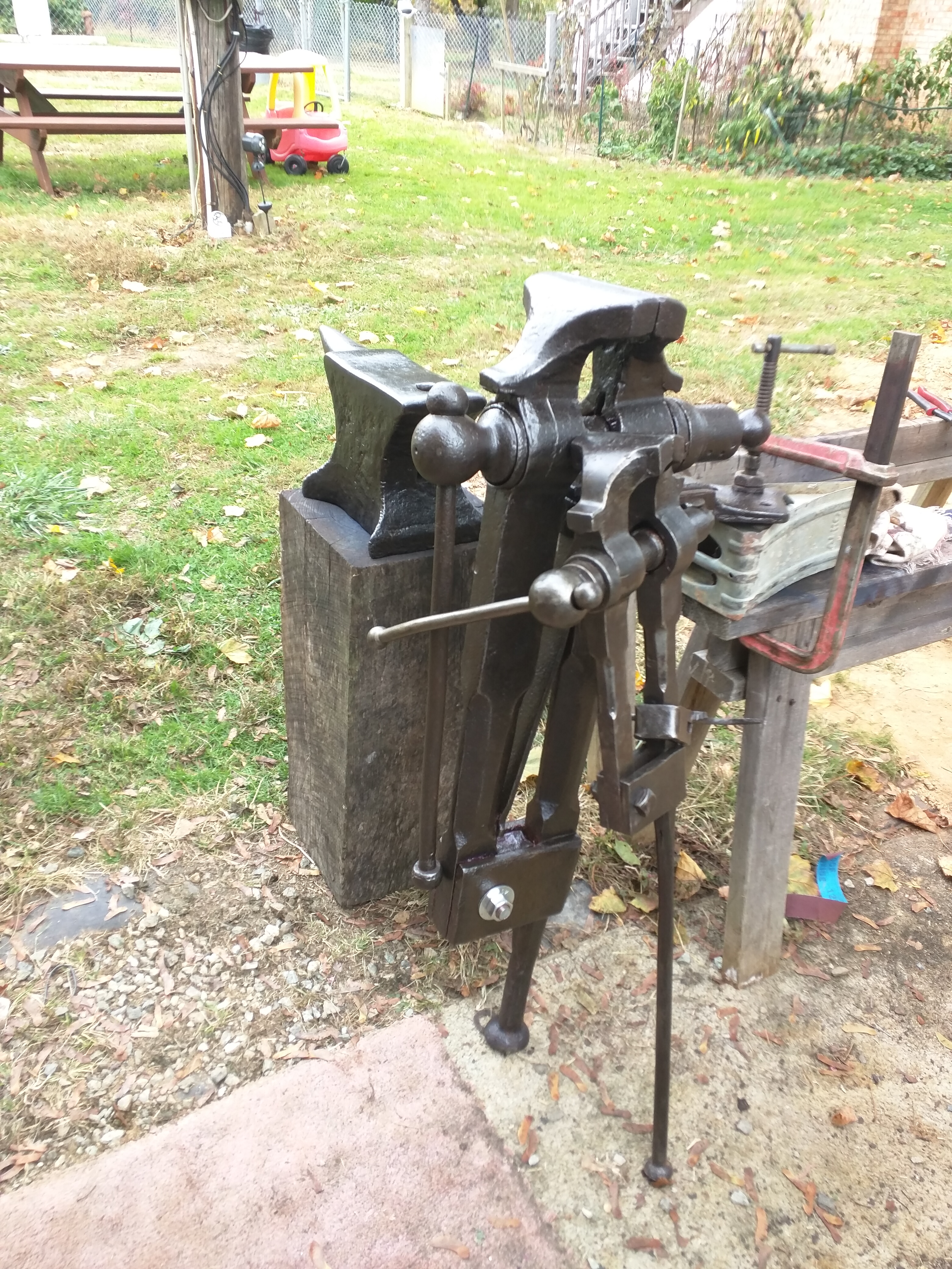

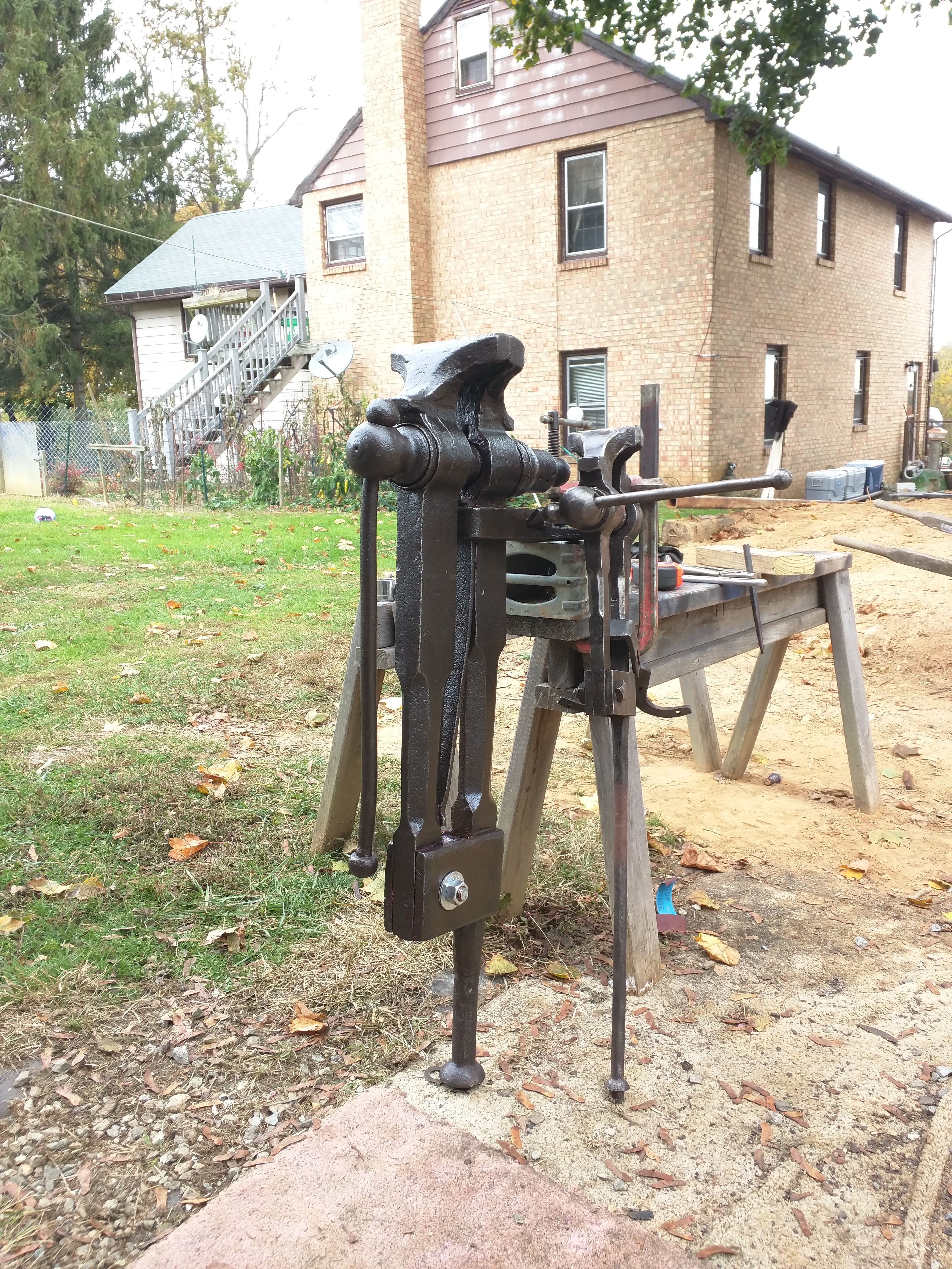

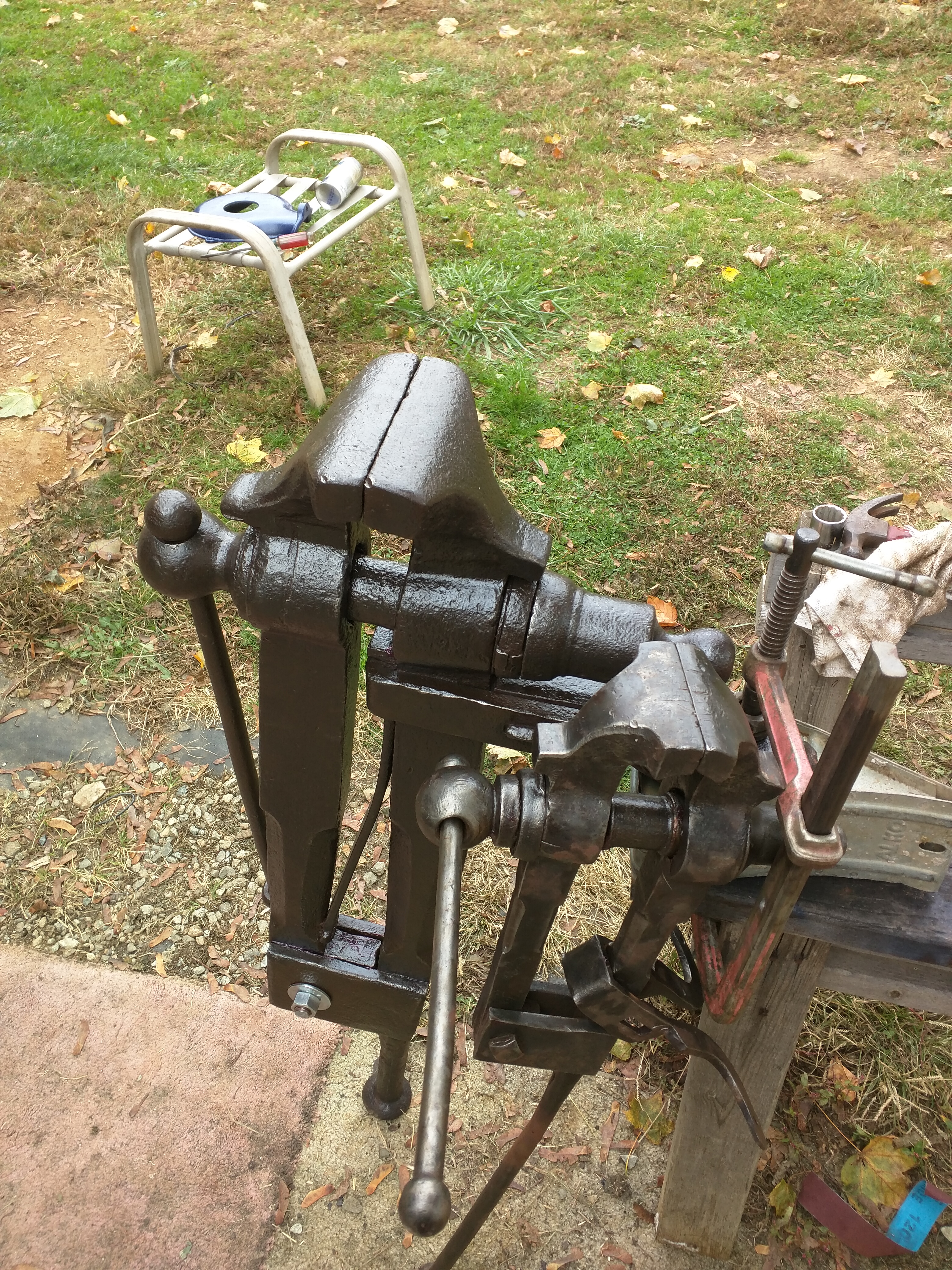

Hi I just picked this up at auction and at a good price, it was all seized up and rusty, but all there, works like new now, just curious about maybe a age and confirmation on maker. It has 7inch jaws and about 150lbs, only mark is a J on the inside leg, its looks all hand forged, tool steel forged welded on the jaws. From reading different post I'm leaning towards a Peter wright. Attached is before and after and next to a 4 inch vise. That's not my set up just got the pictures.

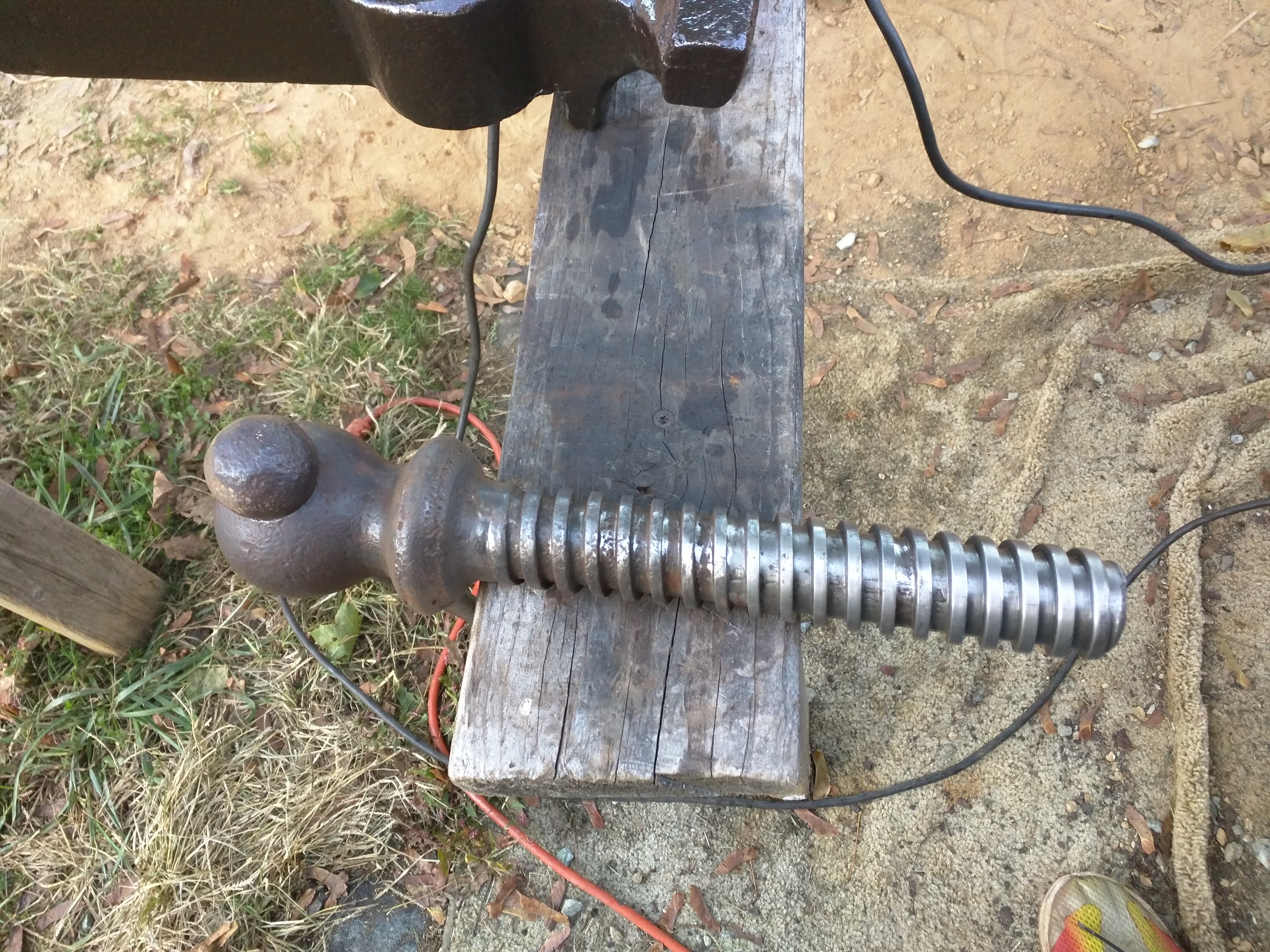

Used wd40 to unfreeze the jaws, the pivot bolt was locked up real bad that took some effort and brute force, when it was apart i used a cup wire wheel on a grinder to get it to get all the heavy rust off, I used a engine degreaser and smooth file with a light touch to get all the funk off the screw threads it was caked on bad, greased all the moving parts, used wd40 on the rest to protect it, not sure if that's what your supposed to use but I like it and gives it a nice gun metal finish that's what I put on the Anvil too. It's amazing to me that such a old tool that was abused and left outside for years and years works like it did new with a little care.
You might want to find something a bit more substantial than WD-40 to protect your vise. It's a decent general purpose lubricant - if I could only have one spray it would certainly be WD-40 - but there are other options that will do almost any job to a more satisfactory standard. Paste wax seems to work fairly well for this sort of thing. I tried that on a vise after several members here recommended it. Not surer exactly how long it'll last, but it has already outlasted what WD-40 would have.

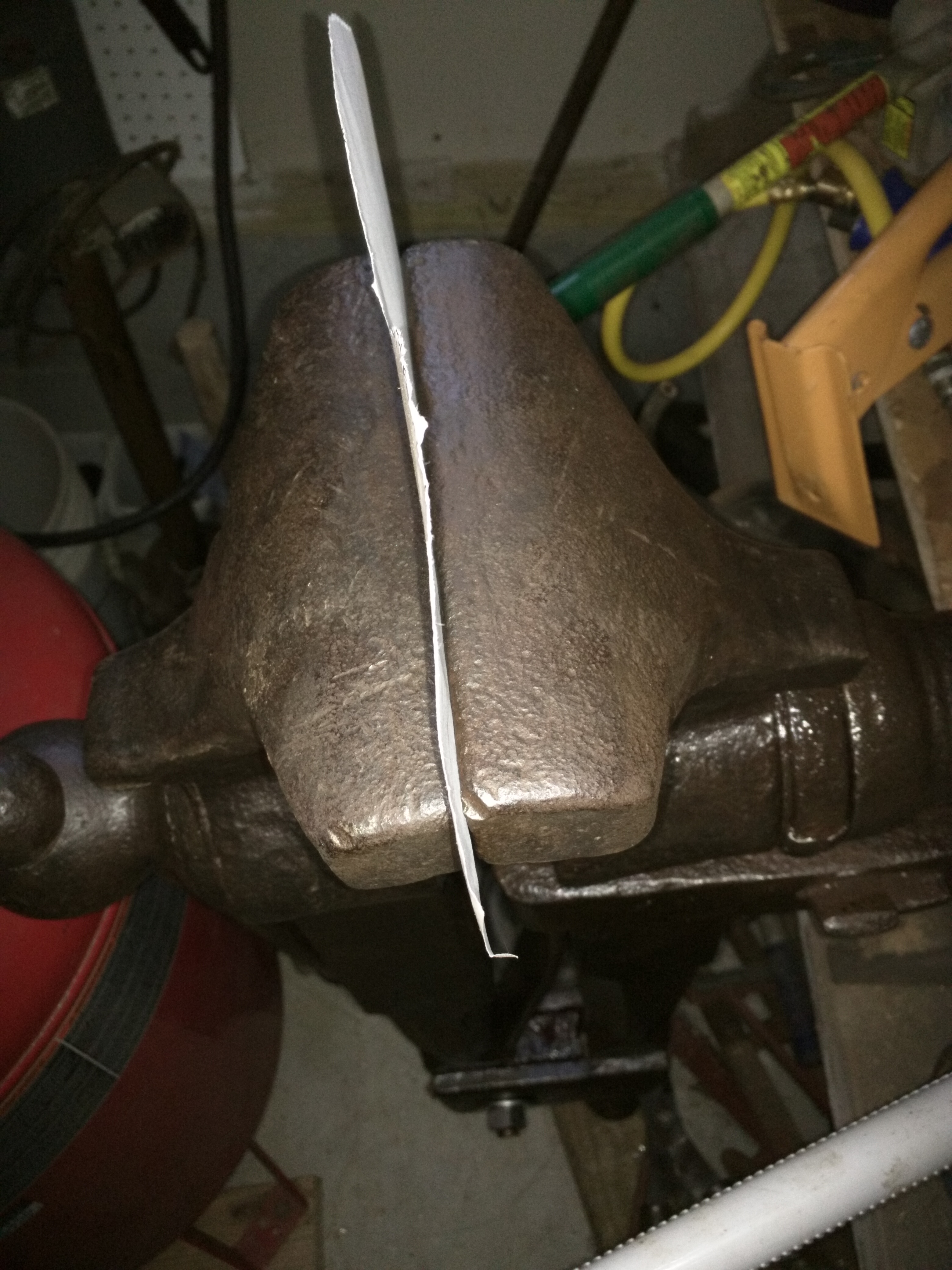

Very nice looking vise by the way. Does it pass the dollar bill test?
Thanks I'll have to look into that paste I'm all for trying new stuff, I used grease on the moving and friction parts, I used wd on the show parts because its going to be in a inside shop. Yes there isn't any daylight when the jaws are shut they close tight and true and glide you could use 1 finger if the bar wasn't so xxxx heavy.
Anti-seize works well for the screws on vises too and lasts a long, long time. Just remember that a little dab will cover the world. Buddy of mine globbed that stuff on something and threw it in his toolbox about ten years ago. To this day anything that touches the bottom of that box gets covered in aluminum. Just something to think about if you ever need to regrease the screw.

I didn't have a $1 but here is a paper test.
