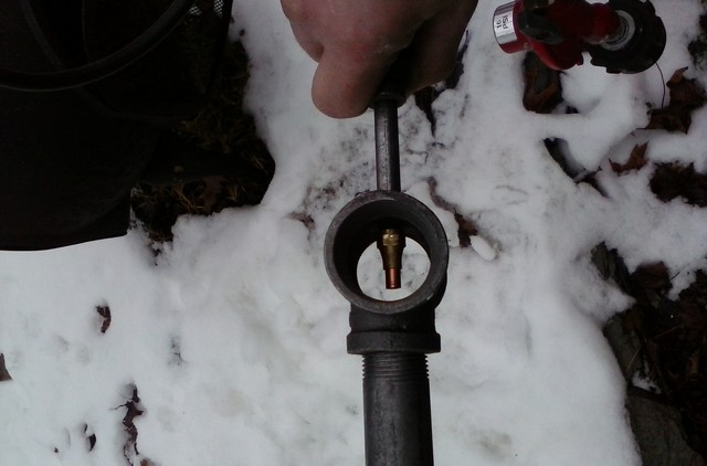

OddDuck Posted January 31, 2016 Share Posted January 31, 2016 Just built one yesterday (Friday) and used it all day today in my foundry furnace, worked like a charm! I have an additional method for drilling the hole, I used my metal lathe and a short nipple to center the tee. Put the nipple in the chuck and center that first (wish I had a 3 jaw, would have made this a lot quicker), screw the tee on the short nipple and use the tailstock to drill the hole. I also used the tailstock to help center the tap to start the threads. I also used my lathe and removed the threads on the two air intake sides of the tee to improve airflow. I had to improvise as to how to hold the mig tip however. I couldn't find the 1/8th" flare fitting, so I enlarged the threading in the tee to allow a 1/8" pipe nipple to extend a ways into the tee. I then took a 1/8" flare nut and tapped it 1/4x28 for the mig tip. Screwed the flare nut onto the nipple inside the tee. I'll try to get a pic of that tomorrow. I also had to cut the mig tip about in half to tune it. I'll be making more of these! Quote Link to comment Share on other sites More sharing options...

OddDuck Posted January 31, 2016 Share Posted January 31, 2016 Okay, here's the pics of the burner, hopefully they are reasonably clear. The last pic probably doesn't show it very well, but I made the flare out of a 3/4" coupler, I chucked it up in the lathe also and bored out the threads on one end of the coupler. Quote Link to comment Share on other sites More sharing options...
