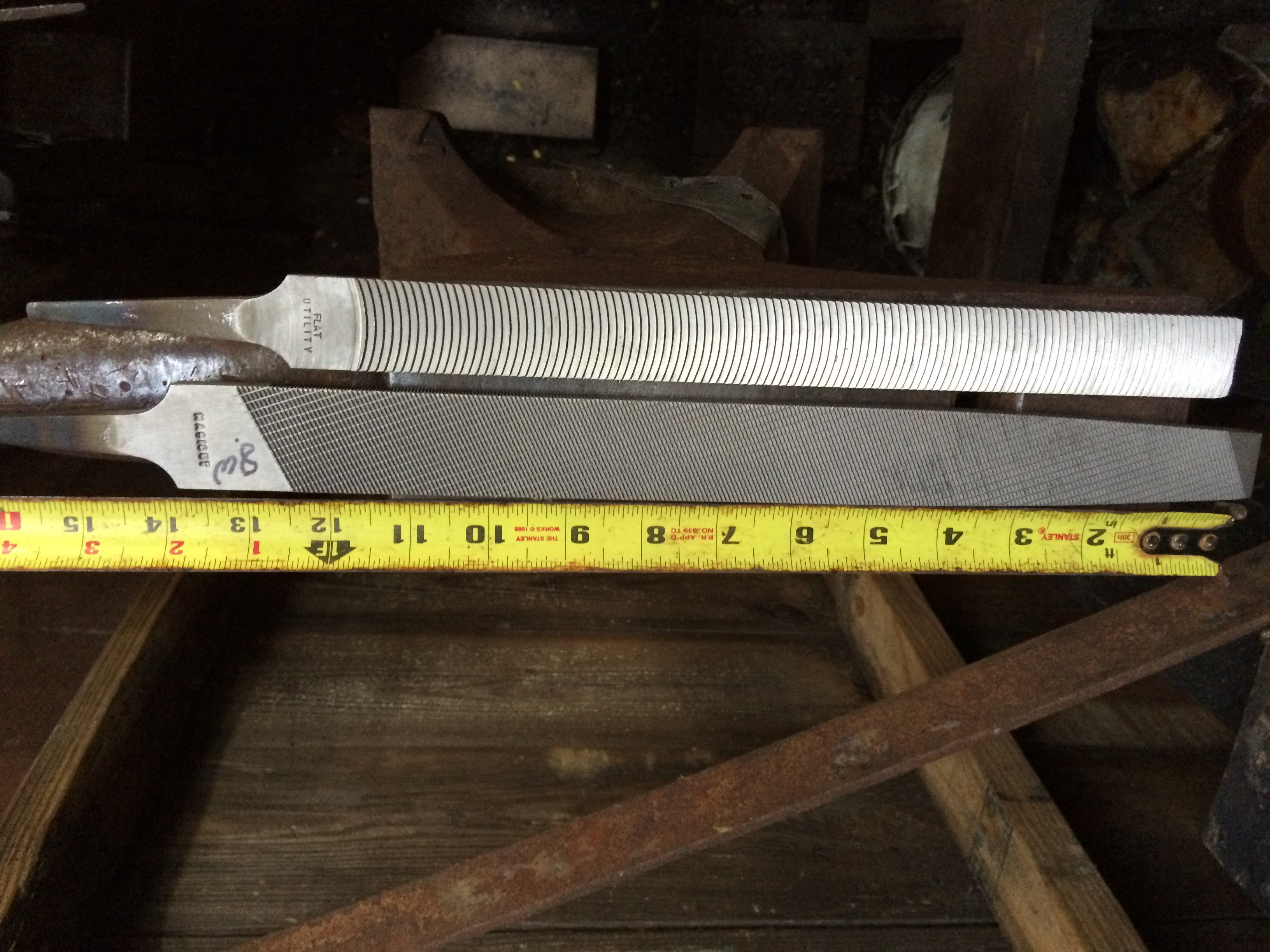

Michael Cochran Posted October 5, 2015 Share Posted October 5, 2015 Just picked these up yesterday at a local tool store for a bargain. They are great for quick removal but are easy to get carried away too. One is a 'utility' and the other a 'magicut' both are Nicholson. Link to comment Share on other sites More sharing options...
