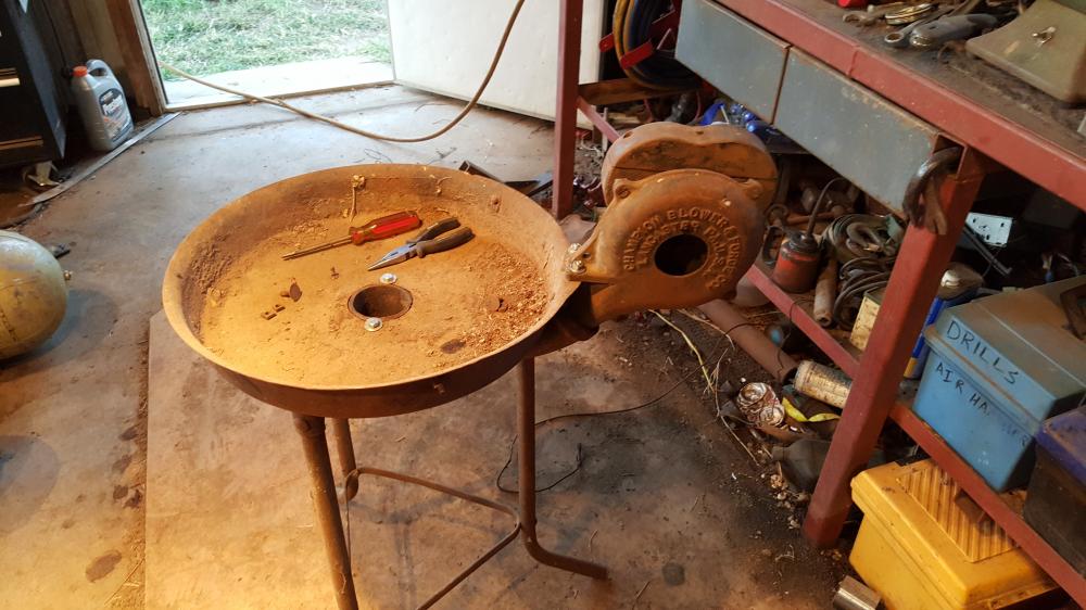

Did not get the coal forge, the guy we were talking to wanted to keep the tools in the family which is cool. Did get quite a bit of coal from him though which i shared with a dabbler friend of mine. What i did do was find this in one of our out buildings. 20151006_190252.thumb.jpg.2c74470797a590Only problems are no grate in the coal pan and no fan in the blower.  Is it possible to get a fan for an old champion blower?
Keep your eyes open though, blowers like that aren't uncommon and that one can become a parts blower.
Air grates are simple affairs a few short lengths of round stock with a little spacer between them to make a little grate works a treat.

Got the fan built for it after a broken bit, thread tap and several new combinations of 4 letter words. Luckily it's covered cause it turned out fairly ugly but moves quite a bit of air. I can't wait to get it clayed and shielded and play around with it.
