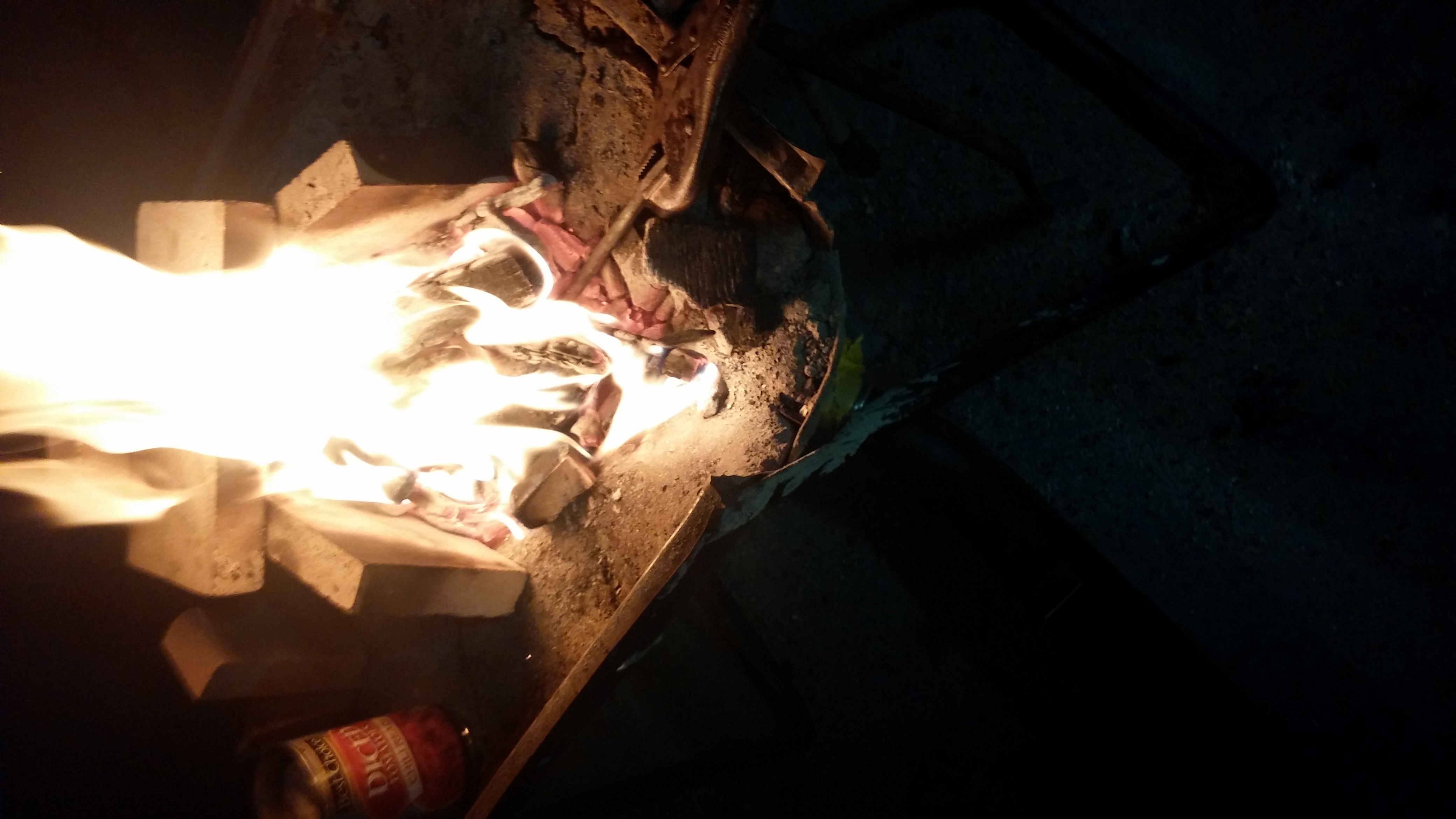

scottyp74 Posted September 1, 2015 Share Posted September 1, 2015 Just did a bit of forging tonight and thought the forge looked xxx xxx in the dark. Here are some pics.and this is what I made not the grandest of things but I made it with my 2 hands Link to comment Share on other sites More sharing options...
Glenn Posted September 1, 2015 Share Posted September 1, 2015 Please use caution when forging after dark. The intensity of the fire is MUCH brighter at night than in the daytime. At night your pupils open up to let in more light so you can see and then you look at the forge and blast the eye with intense light. Link to comment Share on other sites More sharing options...
Frosty Posted September 1, 2015 Share Posted September 1, 2015 That's a fair dinkum spoon. Looks about right for ice tea or flux, of course that's just me.Don't stare into the fire, keep an eye on your steels and the fuel but do NOT stare into it. It can cause IR cataracts. Glenn's warning is too true pupils are open wide so more IR is doing it's thing. Also looking at the flame will really throw your night vision off and you may trip.Forging in dim light is good, dark not so.Frosty The Lucky. Link to comment Share on other sites More sharing options...

gote Posted September 1, 2015 Share Posted September 1, 2015 I never look into the brightest parts of the fire beause it is uncomfortable and that is nature's way of telling me "Don't do it!" Besides, I always keep my fire "black". Meaning that I always keep the glow covered by coal/charcoal that is not actively burning. If I am not using too much blast, the fire is confined below the black layer. If I need to look at the steel I pull it out and then back or scrape the layer away very briefly and then back again.I may be wrong but I believe that I limit heat loss by radiation and that this is a good thing not so much because of fuel saving as because the steel heats up better. I notice that I sometimes have blue flames above the fire which I attribute to burning carbonmonoxide. Carbonmonoxide not only prevents scaling, it even to some extent gives off carbon to the steel even if the amount is negligible in a normal forge.I use a Swedish "field forge" field meaning used by cavalry farriers when out near the battle field. It is an approximately 2'x2' steel plate with a cast iron pot in the middle and blowing through an easily adjustable valve from below.Comments would be welcomeGöte Link to comment Share on other sites More sharing options...
scottyp74 Posted September 1, 2015 Author Share Posted September 1, 2015 I probably looked strange to my neighbors. I was wearing a pair of tented safety glasses. I grew up around welding and cutting torches so i learned the hard way about eye protection when working in low light condition. Thanks for the tips. I will use it for flux. I just started out and an trying to develop some kind of skill, hammer control, and how to tend the forge to be more efficient at it. Any other simple projects i can do to learn these things im all ears. Link to comment Share on other sites More sharing options...
