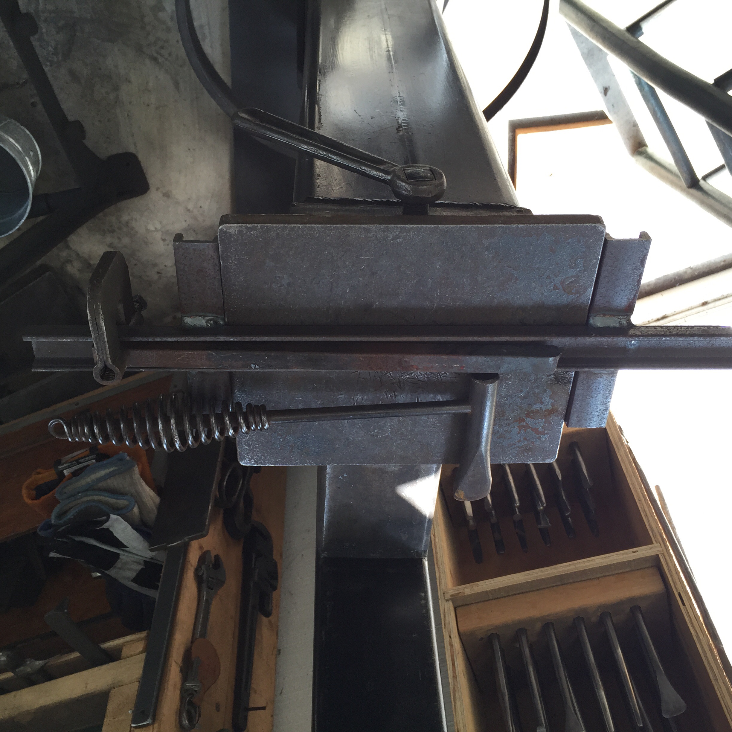

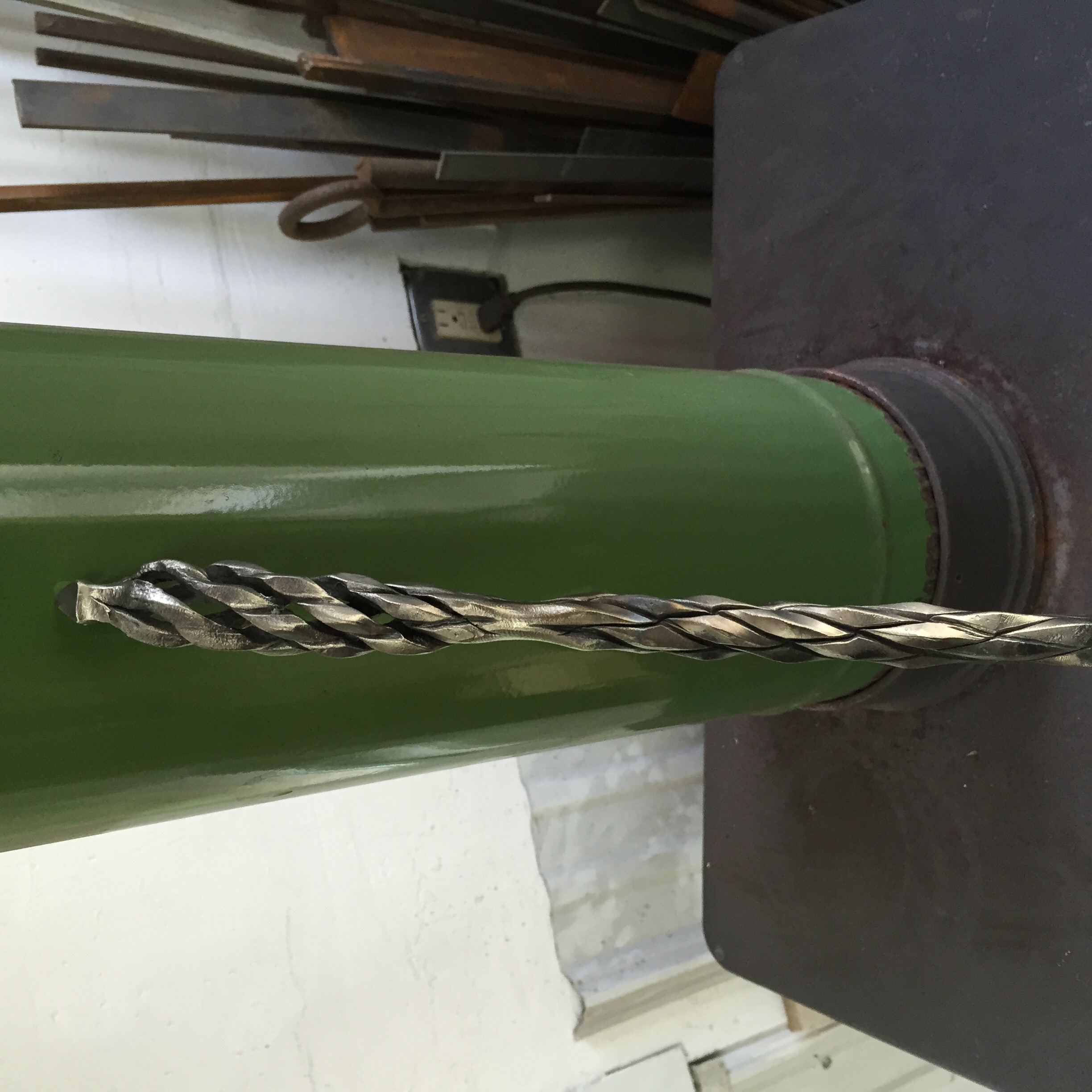

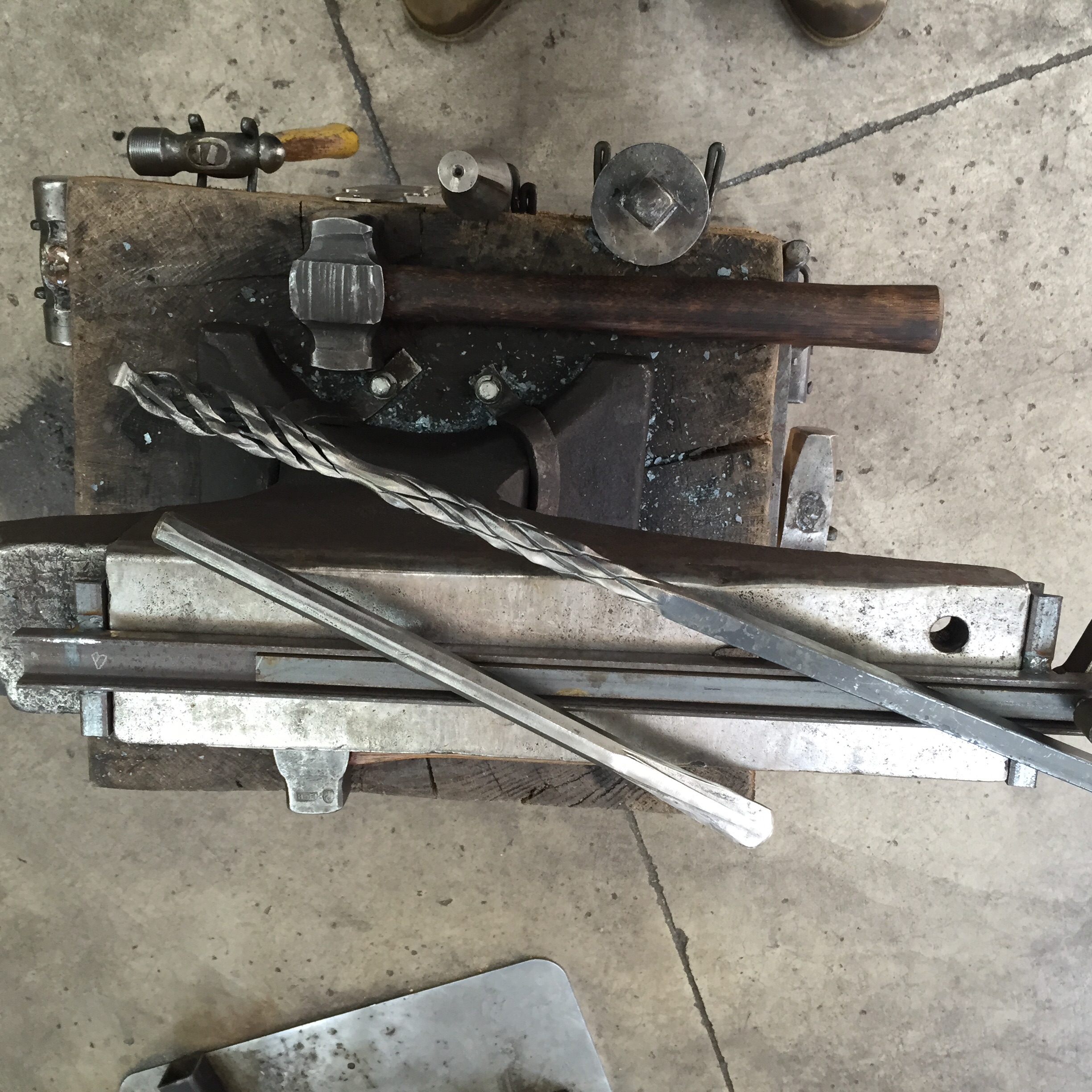

Jim Coke Posted August 29, 2015 Share Posted August 29, 2015 Greetings all,Its been a while . Time for another " WHY DID'NT I THINK OF THAT..A simple piece of 1 inch Chanel with welded ends to use as a guide for scribing 1/2 or 5/8 stock for your pineapple twist.. Works great .. You can also add one to your treadle hammer table which is even faster. It also is useful for round stock texture.. Have fun.Forge on and make beautiful thingsJim Quote Link to comment Share on other sites More sharing options...
VaughnT Posted August 29, 2015 Share Posted August 29, 2015 Isn't it kind of counterproductive to have your treadle hammer's anvil mounted to the ceiling? I'd think the whole thing would work better if you weren't fighting gravity the whole way. Quote Link to comment Share on other sites More sharing options...
Jim Coke Posted August 29, 2015 Author Share Posted August 29, 2015 (edited) Vaughn,Can't seem to flip the picture the right way on my cell.. Oh well just turn yours up side down.. You'll get the idea.. Or if you touch the picture it turns over. Forge on and make beautiful thingsJim Edited August 29, 2015 by Jim Coke Quote Link to comment Share on other sites More sharing options...

ianinsa Posted August 30, 2015 Share Posted August 30, 2015 Vaughn,Can't seem to flip the picture the right way on my cell.. Oh well just turn yours up side down.. You'll get the idea.. Or if you touch the picture it turns over. Forge on and make beautiful thingsJimWhen you find that you just can't seem to get your photos right, just take(use) a tablet! Btw. Jim I thought you had a fly press? Quote Link to comment Share on other sites More sharing options...
Jim Coke Posted August 30, 2015 Author Share Posted August 30, 2015 Greetings Ian,Yep I do have a fly press and as you would guess that's what I use. I post ideas for students and others who can't afford the luxury .. Did you notice that the pineapple twist expands and is open at the end with a small forge weld formed at the end.. Quite a challenge . Have fun across the pond. Forge on and make beautiful thingsJim Quote Link to comment Share on other sites More sharing options...
