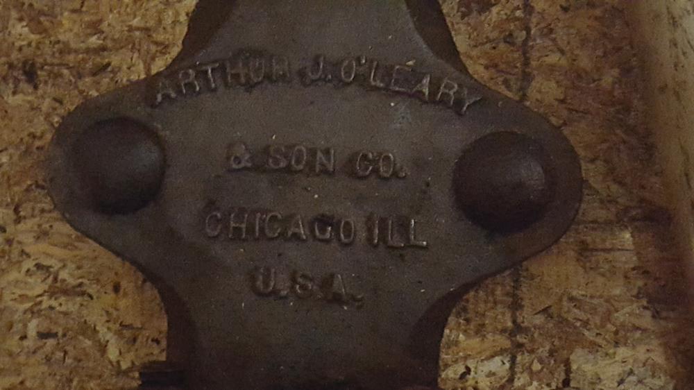

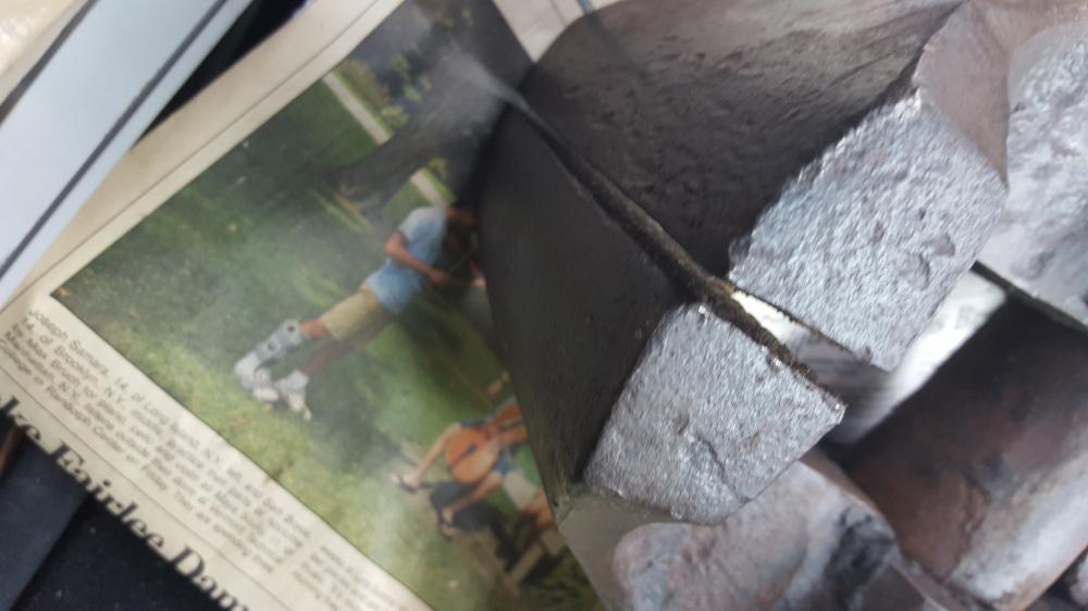

falsevacuum Posted September 7, 2015 Author Share Posted September 7, 2015 I have 4 subaru brake rotors, each 12" diameter. I opted for a wooden stand for ease of construction though. Still need to paint it. The only issue is that it's light and plywood bends, so it wants to topple when I open the vise. I might reinforce the plywood, but I think it's easier just to weigh down back end of the stand. The jaws closed up much better after cleaning. I bet it was the grime getting in the way. Should I bother with a finish for the vise? Maybe paint? I didn't use the power wire brush so I could leave the orignal finish somewhat in tact. Link to comment Share on other sites More sharing options...
Frosty Posted September 7, 2015 Share Posted September 7, 2015 She's a beauty. How do you want to finish her? I painted my smaller vise but yours looks pretty nice as she stands. There aren't any rules really, it's your tool, your shop your choice.Just don't forget pics.Frosty The Lucky. Link to comment Share on other sites More sharing options...
DSW Posted September 7, 2015 Share Posted September 7, 2015 Actually that's OSB not plywood and it's poor for something like your base. Real 3/4" plywood would do better. I lucked out and managed to get a scrap piece of 5/8" steel plate to use like you used that OSB on the bottom. Nice thing is as you stand on the section in front of the vise, it helps hold the vise down. I do use a piece of 3/4" plywood similar to the way you are using that for my compact bender and I haven't had too many issues with the wood bending in use, though I do often park the truck on the back half of the plywood like where your stand is for weight, when bending thicker stuff. If you have any place around that refaces concrete forms, look and see if you can't get a scrap of 3/4" form ply. That stuff has more layers than standard plywood and uses water proof glues. the 1/2" form ply I have is about as stiff as standard 3/4" plywood is. The 3/4" stuff I have I can easily stand in the middle of a 4x8 sheet spanning 2 saw horses without it bending at all. We used to get scraps from Symons Forms in the city, but now get it from the people we get all our concrete supplies from ( Vimco). You should be able to locate some place that does forms if you are near a good sized city. Most big construction companies rent forms and many times the heavy forms that use 3/4" get refaced after every job. Link to comment Share on other sites More sharing options...
