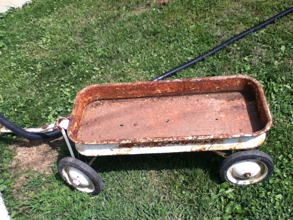

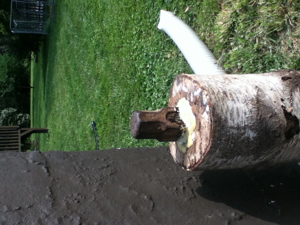

Tempered Warrior Posted August 26, 2015 Share Posted August 26, 2015 I just built this "anvil" today. And do u think I can turn this wagon into a forge its pretty solid Quote Link to comment Share on other sites More sharing options...

ThomasPowers Posted August 26, 2015 Share Posted August 26, 2015 Looks like an anvil to me! Wagon is way larger than necessary. Remember you only want to heat up what you can work before it gets cold. Quote Link to comment Share on other sites More sharing options...

DSW Posted August 27, 2015 Share Posted August 27, 2015 I can see the wagon becoming a forge table. Cut out the center to take a drum or brake disk and maybe cut down the sides a bit unless you raise the pot and floor with bricks ( My preferred method since it would eliminate sharp edges and make it still keep it looking like a wagon for interest.) Sledge looks good. How did you mount it? Looks like you drilled the stump and set it with something like expanding foam. I like it. Quote Link to comment Share on other sites More sharing options...
ThomasPowers Posted August 27, 2015 Share Posted August 27, 2015 Put the wagon up on a couple of sawhorses to get it to a convenient level. Quote Link to comment Share on other sites More sharing options...
Stephen Jones Posted August 27, 2015 Share Posted August 27, 2015 I love the anvil set up. Thomas hit it on the head with the level. If you cant find a couple of sawhorses see if you can find a premade metal frame that would adapt to fit. Quote Link to comment Share on other sites More sharing options...
Tempered Warrior Posted August 27, 2015 Author Share Posted August 27, 2015 yeah I drilled a hole to general fit then hammered it in and gorilla glued it in Quote Link to comment Share on other sites More sharing options...
ThomasPowers Posted August 28, 2015 Share Posted August 28, 2015 Scrambler, look up Tim Lively's washtub forges. You can make a variant with the wagon easily. Shoot I made one out of a 1930's dry sink about a decade before Tim/Tai got started with them. Quote Link to comment Share on other sites More sharing options...
VaughnT Posted August 28, 2015 Share Posted August 28, 2015 That wagon would work wonderfully as a forge table. I'd put a layer of red bricks in the bottom and use a 2" pipe nipple as an extender to get the heat up and away from the thin sheet metal. My first forge was similar, though it was a cast iron body and a little bit thicker than that wagon's sure to be. Still, I never had a problem with a layer of regular red bricks (the joints will soon fill with coal dust and scale, so they don't move around on you. You just want to be sure to get the heat up to the top of the bricks so you can lay your stock horizontally through the center of the fire.As for raising it up to waist height.... no need if you don't want to. Forging from a seated position can be mighty comfortable if you have all your kit laid out right and your stool fits well. I'm partial to old tractor seats that really hug the bum and give you plenty of surface area. Lots of smiths sit down to forge, or squat, or kneel. All depends on what the body likes. Quote Link to comment Share on other sites More sharing options...
Tempered Warrior Posted August 28, 2015 Author Share Posted August 28, 2015 I have some fire brick for the wagon Quote Link to comment Share on other sites More sharing options...
JHCC Posted August 28, 2015 Share Posted August 28, 2015 Make sure you chock the wagon wheels, especially while forging on a hillside. Quote Link to comment Share on other sites More sharing options...
Frosty Posted August 29, 2015 Share Posted August 29, 2015 2-3" of rammed sandy clay will distribute the heat enough it won't warp. One of my first more or less "real" forges when I was a kid was the lid from an old washing machine turned upside down with a hole hacked into it so a brake drum would rest on the rim. I then packed it with adobe. . . several times, I kept mixing it like mud instead of ramming damp. I think I was in Jr. high, 1964 maybe? I stole Mother's hair drier, the OLD school kind with the plastic hair bag, hose and briefcase size blower heater unit.Anyway, that wagon will work fine. Don't over think it though. If you're going to burn charcoal think side blast, it makes for a really simple forge. Charles will walk you through it.Frosty The Lucky. Quote Link to comment Share on other sites More sharing options...
Charles R. Stevens Posted August 29, 2015 Share Posted August 29, 2015 Bottom blast is a PITA with charcoal. Side blast works better for both, but you need a 8" deap box, a fire bowl can be made up out if steel. Quote Link to comment Share on other sites More sharing options...
