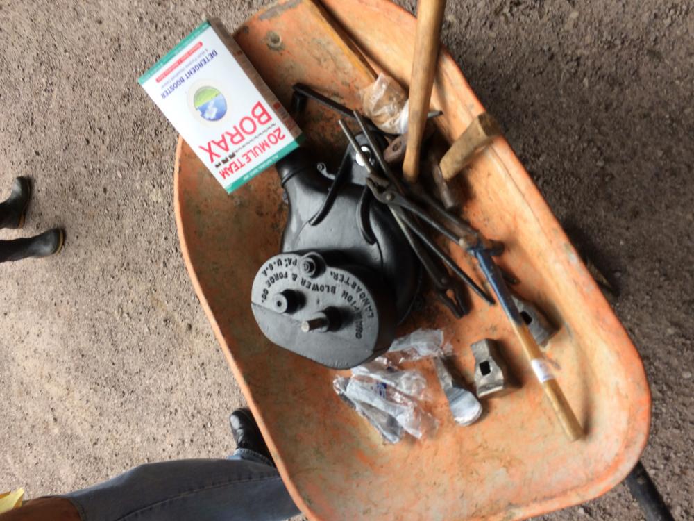

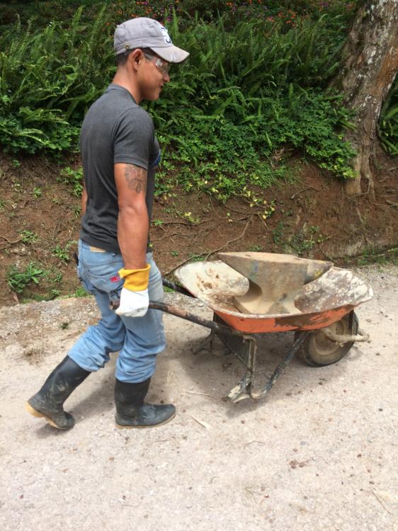

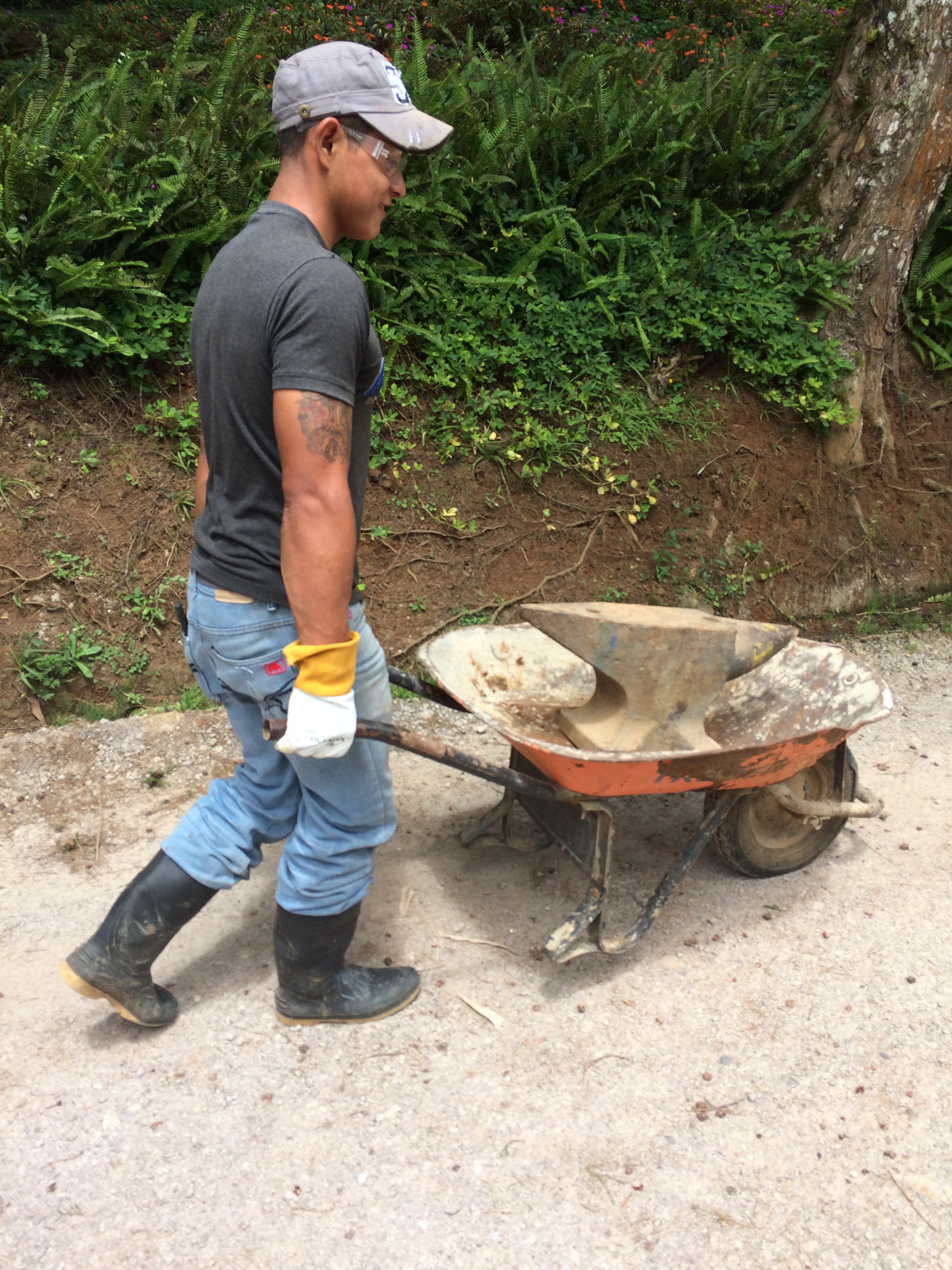

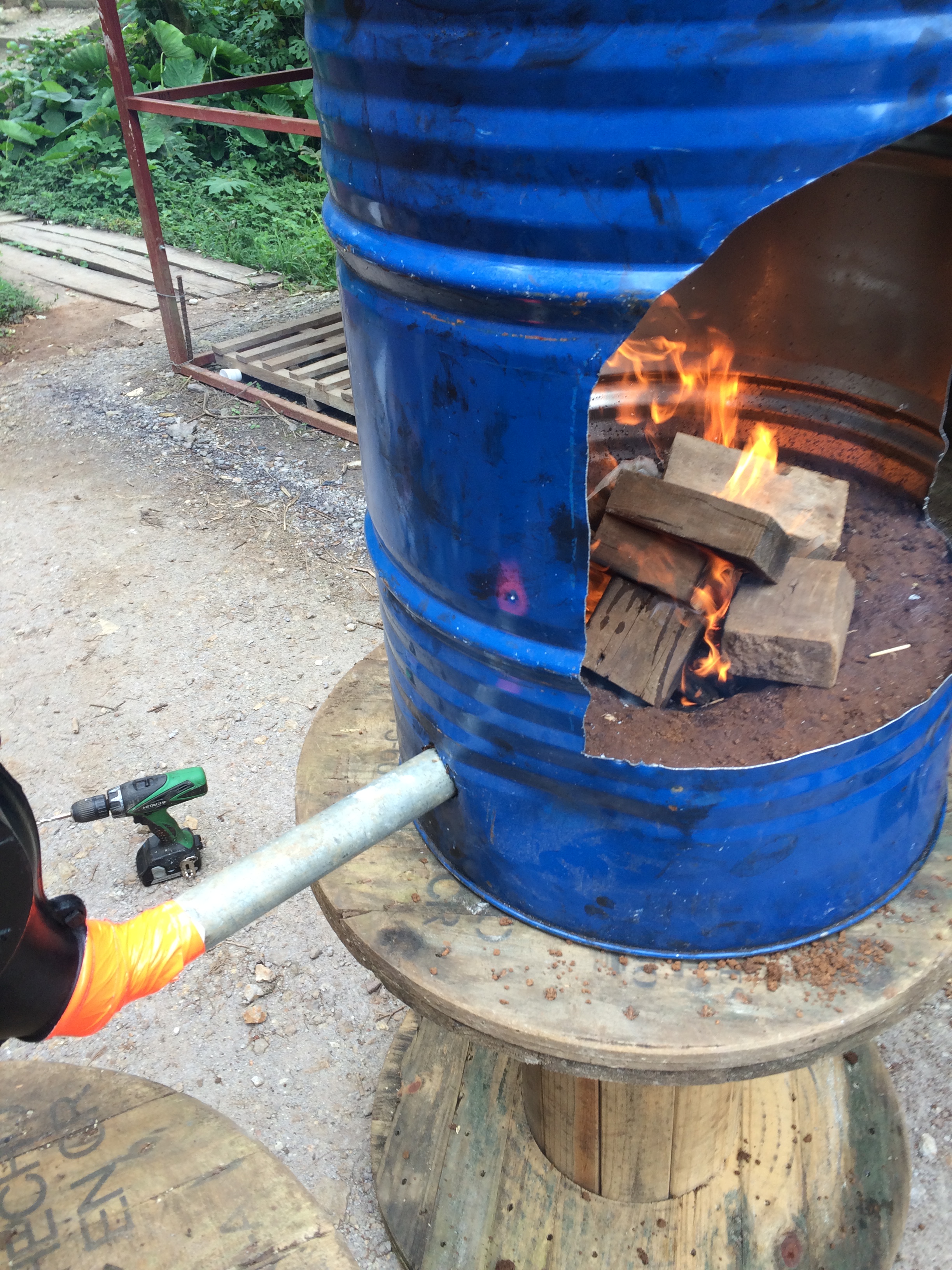

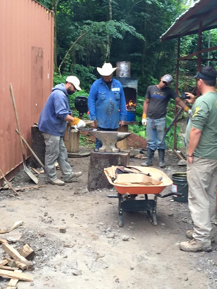

GottMitUns Posted August 16, 2015 Share Posted August 16, 2015 (edited) Thank for everyone on IFI the prayed for us and helped out with info last week! I am happy to report there is a side draft 55 forge up and running in Jinotega Nicaragua!Day one started with our group traveling from Victoria Texas to Managua NicaraguaHomeLoading up in ManaguaDay 2 started with a church service on a coffee hacienda at a church we helped fund last year.Day 3breakfast at 7:00amand unpack what I brought up with me in my luggage.and moving the anvil to its new home. the young man moving the anvil is Nestor and was my student for the weekHere is our basic set up by the middle of the day. by the morning of day 3 we had everything in place and I was ready to start teaching, I had planned on making some simple S hooks to start with until the camp construction manager came to me that morning and explained that they really needed 12 piquetes next week to keep work moving along. A piquetes looks like a hatchet made from a leaf spring that has been cut off about 4" from the shackle eye and then had a wooden handle put into the shackle. They are used to chip a texture into concrete beams before a final coat of concrete is smeared on like stucco. Since we only had one leaf spring with eyes on it we had to bend 10 more. I figured the easiest way to do this was to bend a ruff eye into it over the anvils edge and then drive a drift thru it and true it up so off to town we headed to get a truck axel for a drift. 4 hours later we made it back to camp with a old Toyoda axel, 5 gals of burnt motor oil for quenching and a pint of gear oil for the blower.Since my Spanish and my helper Nestor's English were about on par with each other there was a lot of pointing and grunting going on as I made a drift out of the axel and 3 piquetes then Nestor made the remaining 7. By the end of the day Nestor could make one in about 15 minutesThe next day we heat treated the heads and made wedges for all the handles for them that another team made with a draw knife and then set the wedges.Along the way that day we also made a tool out of a coil spring to bend rebar with, a cold chisel from a coil spring for another project, repointed a 7' chipping bar and 2 jackhammer bits.The last project for the last afternoon was a Fredrick's Cross that I hands off instructed Nestor to make for his mother. I believe he showed it off to worker in the camp and when asked how he made it he would respond it was a blacksmiths secret. I left 4 of the most commonly referred to blacksmith books with them and the address to IFI and instruction to email me with any questions they had and I would try to help out all I could.Thanks to all of you for the info you have shared with me over the last few years, and if anyone wants to go to Nica on a blacksmithing trip let me know! Russell Doerr Edited August 16, 2015 by GottMitUns Link to comment Share on other sites More sharing options...
