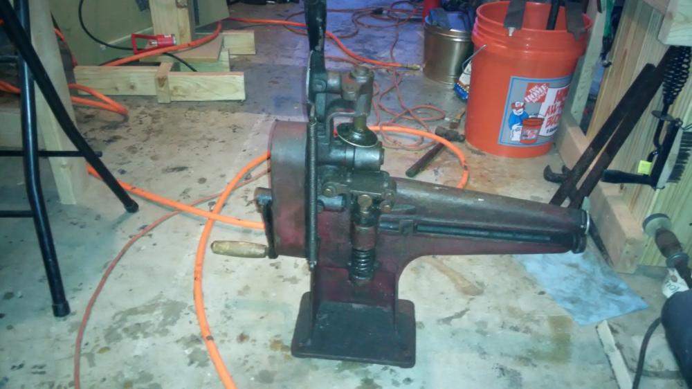

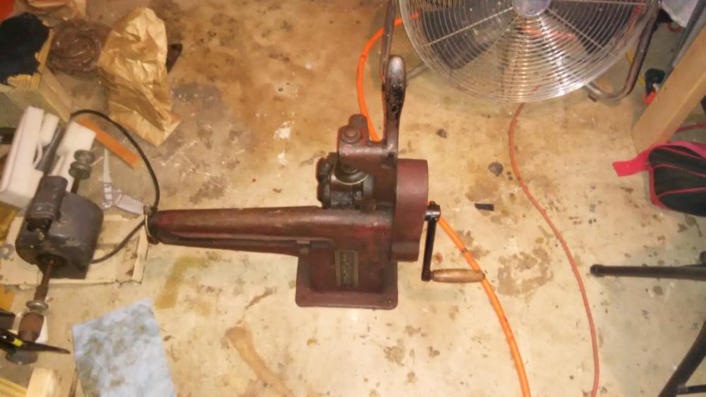

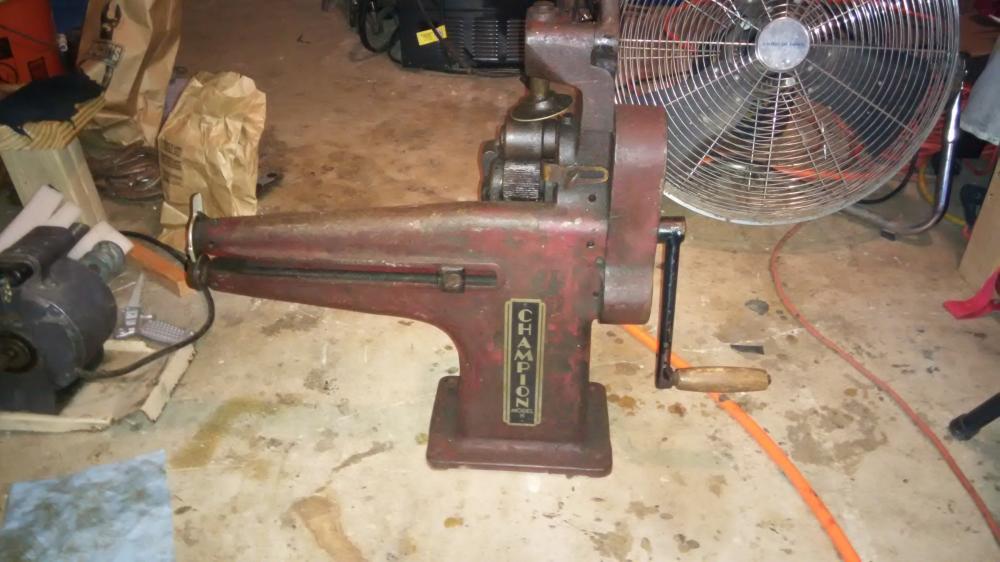

Anthony San Miguel Posted July 7, 2015 Share Posted July 7, 2015 I saw this old leather cutting machine at an antique shop around 2 weeks ago and a quick Google search showed one for sale on Craigslist and eBay for $400. I realize that is the asking price and doesn't mean it sold for that price but the poster also said similar ones sell for $550-$800. Well I bought it for WAY cheaper than $400 figuring that I could probably double my investment pretty easily, even if I just sold it for $200. But now I'm wondering if I should keep it.Maybe I could make nice sheaths or holsters or who knows what with it. Does anybody know anything about this machine? It's a Champion Model H. Everything turns fine on it. I don't have a lot of extra space in my garage for something I couldn't really use and I want to buy or make a small forging press eventually.Any thoughts or info appreciated. Quote Link to comment Share on other sites More sharing options...
bigfootnampa Posted July 7, 2015 Share Posted July 7, 2015 It appears to be a splitter, which uses a planer type blade to shave leather to thinner dimensions. Kind of a specialty tool! Pros sometimes have several but for most hobbyists they'd hardly know what to do with such a thing! My advice is to sell it! If you need to ask what it is you are FAR from ready to need it! Quote Link to comment Share on other sites More sharing options...
Frank Turley Posted July 7, 2015 Share Posted July 7, 2015 I had an old Progressive brand leather cutter with the cutting wheels on the end, similar to the one pictured. However, it did not have the machinery on top as yours does. Bigfoot may be correct that it is also a splitter, making it a combination tool. The cutter was designed for thick leather such as sole or belt leather. I used mine often for cutting horseshoe pads, the pad being between the shoe and the hoof. Quote Link to comment Share on other sites More sharing options...
Charles R. Stevens Posted July 7, 2015 Share Posted July 7, 2015 (edited) If your planning on getting into leather work itisnt a bad tool to have, spliting is usefull when one ends up with cow or bull hides insted of steer hide as steer hide is much more consistant in thickness. And a trimmer is usefull for trimming the thick edges of a sheath. Edited July 7, 2015 by Charles R. Stevens Quote Link to comment Share on other sites More sharing options...
Anthony San Miguel Posted July 7, 2015 Author Share Posted July 7, 2015 Thank you guys, for the replies. I have seen it described as a combination splitter/cutter. I see your point Bigfootnampa. I did buy it hoping to sell it and double my profit to reinvest in something I could use. But I just wonder if it's worth it to me to learn how to use it. I'd hate to later on be in a position where I'm making a sheath or something and wish I had kept it because it does sound useful. But I'm running out of space in my garage! Quote Link to comment Share on other sites More sharing options...

David Einhorn Posted September 26, 2021 Share Posted September 26, 2021 It is a Champion model h - 5 in 1 Leather machine, similar to the Landis 5-in-1 machine. It cuts, skives, presses the edges of shoes for soles that are glued with contact cement, welt roller, and bevels edges. . landis_25_manual.pdf Quote Link to comment Share on other sites More sharing options...
