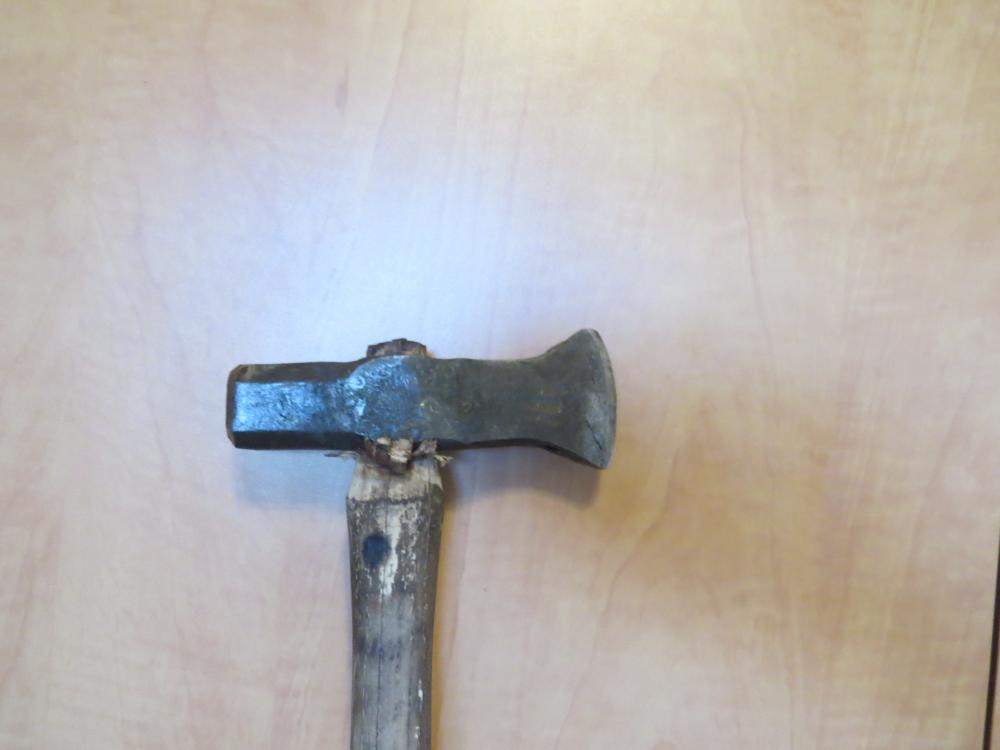

Ethan the blacksmith Posted May 4, 2015 Share Posted May 4, 2015 I will be posting videos and pictures of some tools that I will be making in the near future. ex: hammer eye punches, cupping tool, drifts, fullers, ect...made my first set hammer today! its not perfect, but should work good. Link to comment Share on other sites More sharing options...

Ethan the blacksmith Posted May 20, 2015 Author Share Posted May 20, 2015 more tools for hammer making! We have a smaller hammer eye punch, and the next tool I did not make, but I made the handle!hickory isn't cheap! if any body has a method of making a fuller it would be appreciated! Link to comment Share on other sites More sharing options...

matto Posted May 21, 2015 Share Posted May 21, 2015 Ethan clean the mushrooming off the fuller. For handles check the pallets you have for top tools the cotton wood will work. Then some of them might be oak or ash and you can make your handles from that for your hammers. Link to comment Share on other sites More sharing options...

Charles R. Stevens Posted May 22, 2015 Share Posted May 22, 2015 Well sir, i'm glad your still here. I have no doubt that your love for that woman had a little to do with you clawing back to the light.sorry for hijacking your thread, Ethan.i assume you are asking after a bottom fuller? Many ways to skin that cat, with the skills you have demonstrated, i would suggest upseting a 1" square stock about 3 or 4" down, then split to yhr upset, fold out the peices and rough forge, grind out the cold shunt (thats why the extra meat from the upset) then finish to mach the top fuller. welding woks just as well. Link to comment Share on other sites More sharing options...
