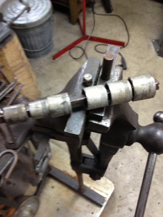

Jim Coke Posted March 24, 2015 Share Posted March 24, 2015 Greetings Jim,I have posted this simple bending tool before but thought you might find it of interest.. Just angles with a welded end of a 1/2 in socket extension and the other a simple fulcrum pin... A useful tool for those junk sockets and flea market finds.. Have fun...Forge on and make beautiful thingsJim Link to comment Share on other sites More sharing options...
VaughnT Posted March 24, 2015 Share Posted March 24, 2015 I've been using something similar to Jim's socket bender for years, and it works a treat if you don't need to go beyond the largest socket you have.For bigger circles, the sections of pipe welded onto angle iron is the way to go. I use a fork or vise grips to hold one end to the pipe while making the bend, but you could also try using a moveable peg much like is done with the socket bender.The biggest issue I have with the pipe sections is finding a pipe that's the right size. You can get a lot of little pipe at the home stores, but finding stuff that's 3", 4", 5", 6", etc, has proven rather impossible for me. If you do run into a supply of the larger sizes, I'd be happy to talk trade for some slices! Link to comment Share on other sites More sharing options...
Charles R. Stevens Posted March 24, 2015 Share Posted March 24, 2015 Impact sockets come in 1/4-1" drive, and this is a good use for some of the "off shore" no name brands.pipe and large pulleys certainly work as well but it is hard to beet Mr. Cooks set up for 6" and smaller. (Some large sockets for axle nuts and such are simply a pipe forged to fit the nut and a pice of flat punched and welded inplace. The sliding angle takes the place of the spiral drilled circle. Link to comment Share on other sites More sharing options...

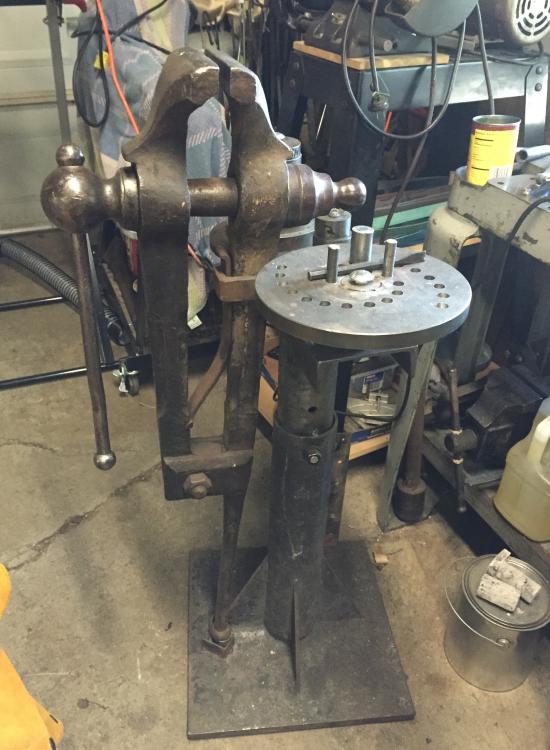

KRS Posted March 25, 2015 Share Posted March 25, 2015 This is what I have done:If I don´t use it for bending it doubles as a coffee table. Link to comment Share on other sites More sharing options...
Gergely Posted March 25, 2015 Share Posted March 25, 2015 That's pretty cool stuff, KRS! VaughnT: is it possible to use bearing rings instead of pipe slices? Bearings are in all sorts of sizes, and they are common at scrapyards.Bests:Gergely Link to comment Share on other sites More sharing options...
JimsShip Posted March 25, 2015 Author Share Posted March 25, 2015 Jim, How are those pins attached? I don't see any weld marks... Link to comment Share on other sites More sharing options...
arftist Posted March 25, 2015 Share Posted March 25, 2015 Gravity. Link to comment Share on other sites More sharing options...

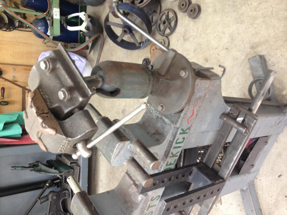

swedefiddle Posted March 25, 2015 Share Posted March 25, 2015 Jim,They will be welded on the underside, then the weld won't be in your way. Bonus = added support.I have a similar thing that I use, Infinitely adjustable. K.I.S.S.Neil Link to comment Share on other sites More sharing options...
Jim Coke Posted March 25, 2015 Share Posted March 25, 2015 Greetings Jim,The pins are drilled and welded from the back side... Easy set up.. \The original JimForge on and make beautiful things Link to comment Share on other sites More sharing options...
arftist Posted March 25, 2015 Share Posted March 25, 2015 Sorry I thought you meant the pins in the spiral jig. Link to comment Share on other sites More sharing options...
JimsShip Posted March 25, 2015 Author Share Posted March 25, 2015 LOL arftist, i thought you were being a wide guy, and appreciated the remark! Thanks for the info "Original" Jim! (Or should I say Jim 1.0?) Link to comment Share on other sites More sharing options...
