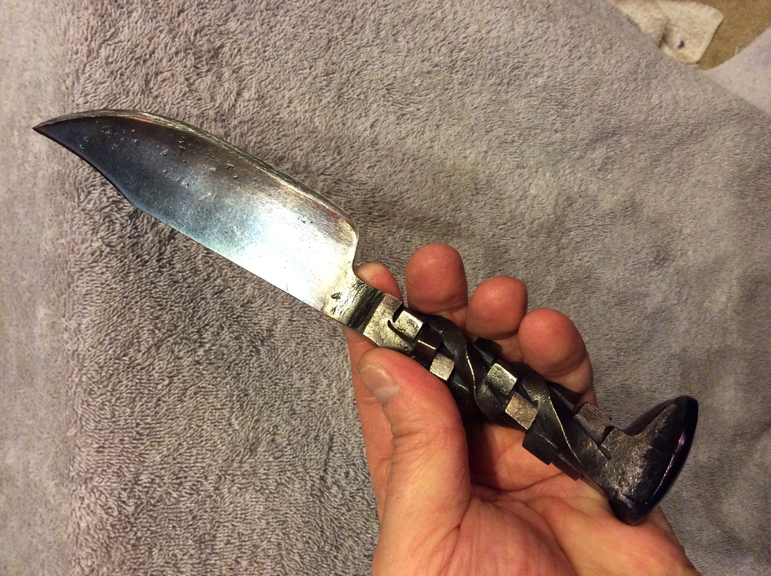

Frozenforge Posted March 16, 2015 Share Posted March 16, 2015 An old friend of mine asked me to make a rail spike knife for him, I normally tell people that I don't make knives so this is my first. I don't have the experience and materials to make what I would consider a proper knife so I told him its more for the look. Quote Link to comment Share on other sites More sharing options...
winginit Posted March 16, 2015 Share Posted March 16, 2015 frozenforge good job that knife looks great !! Quote Link to comment Share on other sites More sharing options...
LibrariaNPC Posted March 17, 2015 Share Posted March 17, 2015 Technicus, thanks for sharing that video! A local blacksmith just told me about it this past weekend, and I'm looking at attempting this when I fire up the forge this weekend (need a set that's a bit more reliable for spikes).Frozenforge, that's a really awesome handle. Care to share how it was done for us newbies? As for the original topic: the others already put in a lot of good details. My wife found that a number of people make hatchets and gardening tools, so she's been pestering me to get more practice in to make these things. I've seen some snakes, wall/coat hooks, and I might be using spikes to make handles for my tool stump. Quote Link to comment Share on other sites More sharing options...
Frozenforge Posted March 18, 2015 Share Posted March 18, 2015 Research a staircase twist, Im sure there are some videos on the internet. Quote Link to comment Share on other sites More sharing options...
Malice9610 Posted March 18, 2015 Share Posted March 18, 2015 There is a video on Youtube showing how to do that twist that explains each step. Search " Rubix Cube twist blacksmith " will pull up a few. Also check out " Pineapple Twist Blacksmith" also, that one is pretty cool as well and the guy shows how to do it very clearly.I have yet to try either one, but that is due to my complete lack of being able to hot cut anything even remotely straight, Need to work on that skill first... Quote Link to comment Share on other sites More sharing options...
