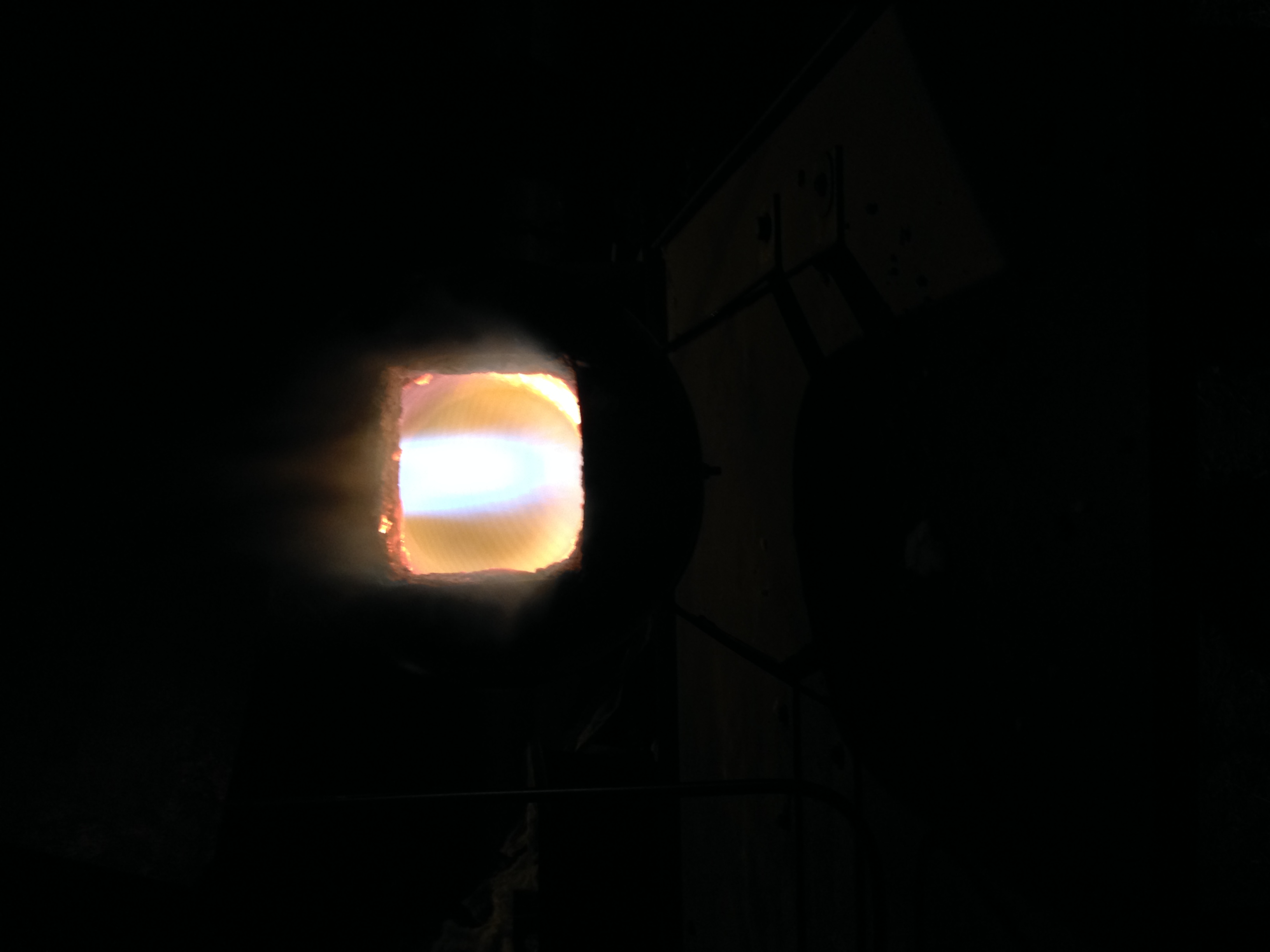

It's coming together. I did a test run without the rigidizer so I can see how a couple different burner ideas work. This was a compressed air blown slotted pipe burner running at 2-3 psi at the regulator with a needle-valve for fine-tuning. The air was fed from a compressor with regulator pressure at 35 psi and a needle-valve for finetuning. It works pretty well. Going to try a couple more burner configurations before I finalize the build. Coolest thing about this build is that I have been lucky/diligent enough with my scrounging and such that the only purchased things for the forge as pictured are the propane regulator (0-60 psi , gotten for US 2$ at scrap yard) and the propane tank refill.
 I finally got the parts together to put together a 3/4" Frosty T-burner... HOLY COW!!! that will be my burner. I don't know if I can tweak the tip depth any to get a better result as far as lower psi needed on my propane, but at 6 psi it is more than plenty forging hot.  I'm talking mid-high yellow... move up to 9 psi and I'm getting white hot. This is without rigidizer, refractory coating or ITC(or equivalent) coating yet. So the original picture I was going to post is meaningless. Hopefully I can get my rigidizer and a layer of refractory in it by next weekend.

Lol... I managed a forge-weld last weekend. Started what I hope to be a PW billet worth making a blade from. Welded half a broken Nicholson file to a piece of A36. The weld seems solid. the piece so far is about 1 1/8" wide by 5/16" thick and about 6" long. I ran out of propane while flattening and prepping for the first cut and restack. I'm currently working out of state, due to head back home late Saturday the 13th... maybe I'll refill my tank and try to pick up where I left off.
You bet that baby can weld. Congrats. That's one of the down sides of a propane burner, they're loud, gun or N A, they roar. Folk driving in our driveway can hear the forge before they get to the house. Nobody coming over to play in the shop needs to knock at the house door but they DO have to shout to get my attention when they come in the shop. Unless I happen to be looking that is.

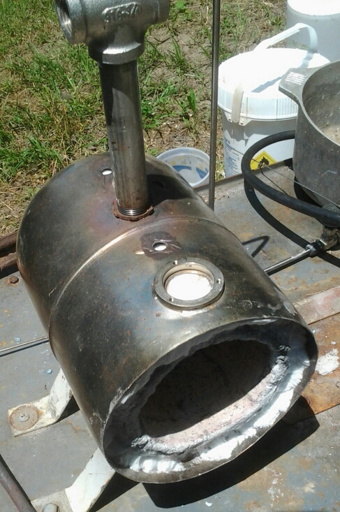

I relined it using BlueRam HS. Did it the way I understood Frosty to have done... two cardboard tubes with a 1/2" gap between them mounted on end on a board. Then used a stick and mallet to ram the refractory in, packing it until the mallet bounced off without noticeable further packing. Added a little at a time this way until the space was filled.
I then unfastened the tubes from the board and inserted them into the forge body to mark the burner hole location. A quick two minutes with the right size hole saw while the refractory was still fresh and voila... a nice clean hole.
Let it set for two days then removed the inside tube and stuck a 100W bulb in it for four days.
Took the outer cardboard off and wrapped two layers of 1" thick Inswool around it...  and dropped it.
After a few choice words, I wet the broken edges, used some fresh refractory to pack between them and coated the outside with about a 1/4" coating (after packing by hand) all around . Carefully re wrapped the Inswool.. Wrapped that with the Sunday funnies and taped with paper tape. Barely managed to slide that into the body.
Too frustrated to wait longer, I reinstalled the 3/4" Frosty T-burner, set my pressure to 4# and lit it off for about five minutes.
After letting it cool for thirty minutes I lit it for ten. Let it cool an hour and turned up the pressure to 10# and ran it for ten minutes.
By this time, the refractory was no longer blue. It had turned a light grey and when I tapped it with a piece of steel, it went "rink" instead of "think" and didn't leave a mark.
Thrilled, I lit it off and made a hand sickle for clearing the weeds along my ditch. Used a piece of spring about 3/8" diameter to make it from.  I'll have to get pics of the sickle later. I used a claw hammer handle I picked up that someone had snapped right at the head and threw away.
I'm attaching daytime photos of the lined forge. Any comments will be appreciated. I do plan to make a flat insert from the BlueRam HS to bring the floor up level with the bottom opening of the pass-through in the back.

The flame shape looked good in the pic. You mounted the jet differently than I did on the last few I made but it works. I'd say the fitting threaded into the T allows you to adjust the jet depth without having to remove, cut and clean it up like I do. I think it's a better set up than my last incarnation set up.
I'm changing the way I mount the mig tip in mine next time. I used the brass fittings because I couldn't find 1/4" scd. 80 pipe without ordering it. I understand one of the suppliers caries it in stock now so I'll be calling around. That will simplify mounting the jet and making it adjustable a LOT easier.
