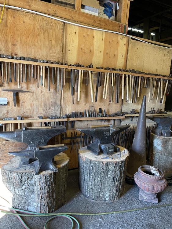

Glenn Posted February 28, 2014 Share Posted February 28, 2014 If you have used these anvils please post a review of that anvil to include weight, dimensions, and how the anvil worked for you. Photos are encouraged. Please include how you found the anvil and any history of YOUR anvil. This should be much like a book review, only an anvil review, where you comment on the specific anvil. A suggested comment could be as follows PICTURE (if available) 1) Weight, make, year of construction and material 2) Rebound test (%) 3) Where did I get it? 4) History 5) Personal review: Why do use or prefer that anvil Would I recommend it to someone else. The following is a list of anvils (used with permission). I am sure there are others but this will be a start. If you know of other brands please all them to the list so we can write a review. Acme Ajax Alsop American-Ross American Skein and Foundry Arm and Hammer Attwood Stourbridge Badger Baker Bay State Black Jack Black Prince Bradley Brooks (Baker Vaughans Ltd.) Brooks and Cooper Buffalo Forge Centaur Forge (by Kohlswa) Central Forge (cast iron) Champion Charles Hadfield Cliff Carrol Columbus Anvil and Forging Columbian Harden Co Columbus Forge and Iron Cranberry CW Delta Denver Dural DuraSteel Euroanvil Fireside Fisher-Norris "Eagle" Fulton Grizzly (cast iron) Hay Budden Henery Wright Herculies Hofi Indian Chief Insonora J.E. Pilcher JHM Anvils Kim Bach farriers anvil Keen Kutter KL Kohlswa Lakeside Louisville Forged Anvil M & H Armitage Mankel MFC Hollow Core Mouse Hole Nimba NC-Tool Oak Leaf Old Forge Old World Onsteel Paragon Pedinghaus Peter Wright Rat Hole Forge Record Refflinghaus Rhino R. Redding Rock Island Roberts Anvil Sampson SISCO (Swedish Iron and Steel) Sligo Snyder & Oaks Soderfors Southern Crescent Standard Star Trenton Trenton Indian Chief "USA" cheap cast iron Valley Vernaium Steel Village Forge Vulcan Arm-Hammer West Wilkinson William Foster WT (Wholsale Tool - cast iron) Yost "Y" in a circle I spoke with Mr Richard Postman and he graciously gave his permission to use the names and brands listed in his book. Vanadium Link to comment Share on other sites More sharing options...

jmccustomknives Posted September 9, 2014 Share Posted September 9, 2014 200lb Fisher. Dated 1942, military surplus. Rebound 85%. This is my main anvil. It spoiled me. (my neighbors love it too, but don't know it). My second is a 126lb Kohlswa. Cast steel. Rebound 75%. Rings like a bell. Bought it for a demo anvil. Works very well, too loud for neighborhood work. Lastly is a 1911 Mouse Hole. 92lbs. Wrought/ steel top. Rebound 65%. I bought this one for a demo anvil as it is lighter and has that gnarly look that speaks of history. Link to comment Share on other sites More sharing options...

Steve2md Posted March 31, 2016 Share Posted March 31, 2016 Mine is a 1901 Soderfors 225#. Paid $800 for it. Loud as can be and fantastic rebound. Best anvil I've ever had the pleasure of using. A previous owner mangled the far edge a bit by using it as a torch cutting table, but that hasn't caused any issues. I may or may not repair it. So far though, I like it how it is Link to comment Share on other sites More sharing options...
