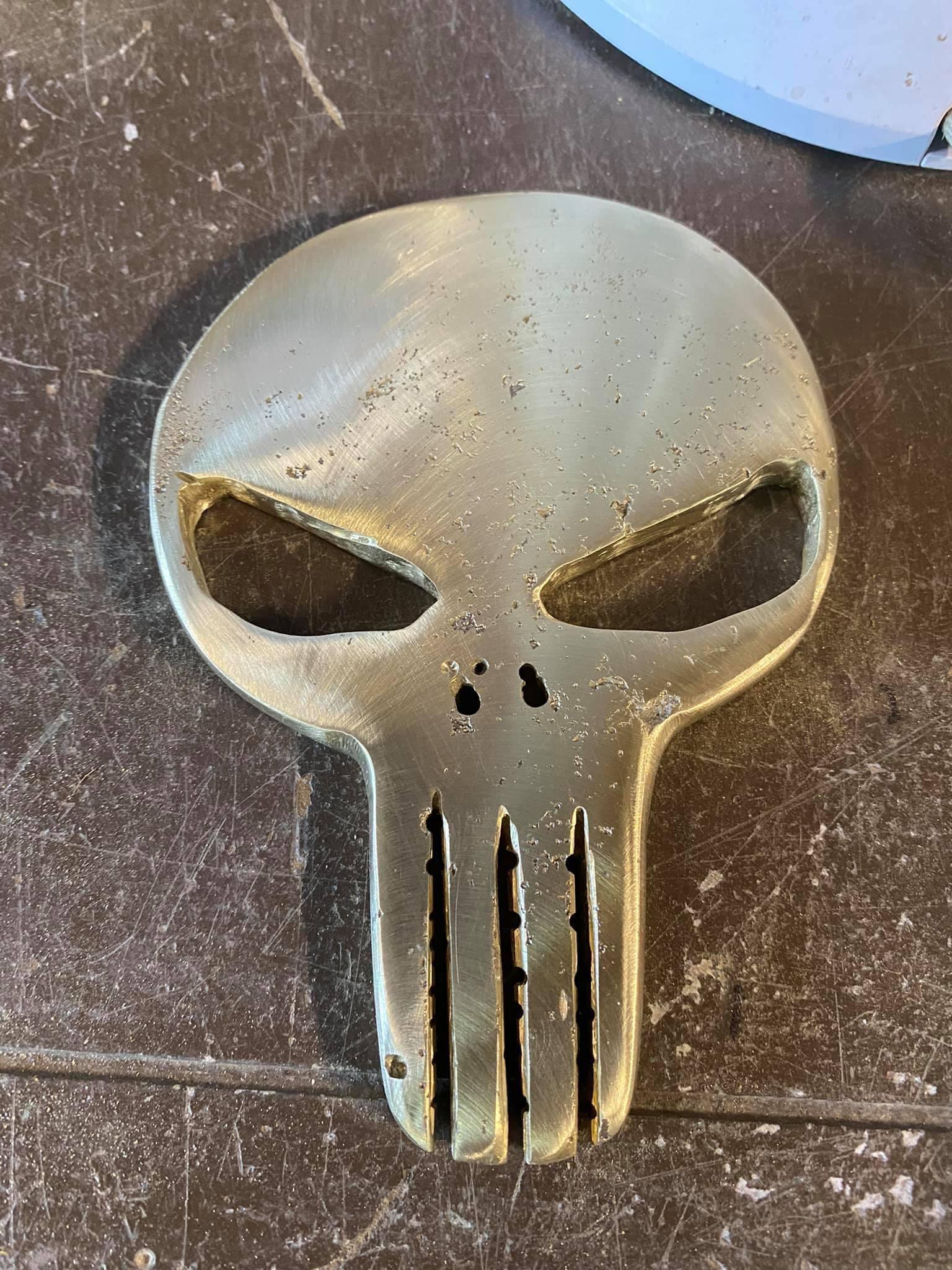

11xray Posted July 25, 2021 Share Posted July 25, 2021 I have had plenty of luck with pouring brass from scrap, thrift shop stuff, etc. I had one accident, but that was me, not the material. However, I do believe I had it too hot when I poured that time. Here’s one example of a green sand molded punisher logo, it weighs about 1lb. Lol! Quote Link to comment Share on other sites More sharing options...

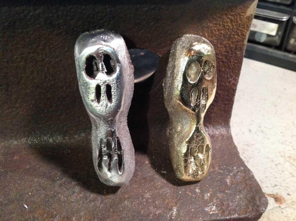

Scott NC Posted July 28, 2021 Share Posted July 28, 2021 I like your punisher! Here's a couple of skulls I produced back in my casting days. I read your other comment about what can go awry, thanks from me as well for posting it. I melted for years and am blessed that I never had one incident. Quote Link to comment Share on other sites More sharing options...
