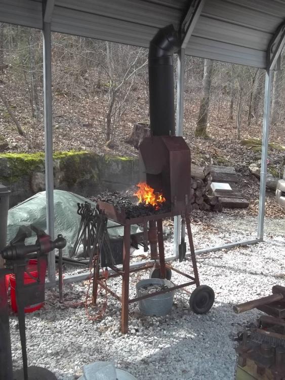

arkie Posted April 30, 2016 Share Posted April 30, 2016 My forge is a semi-portable brake drum type that I use it under a tall (8' eave, 10' top) metal carport. Currently, the flue is a four foot piece of 8" stove pipe with a 45* top to divert the smoke to the center of the roof, as can be seen in the attached photo. Most times it draws well, but only with a fairly strong fire. I don't want to put a hole in the roof and if I divert it out to the sides, I run the risk of embers blowing out into the dry leaves, etc. on my hillside. I have two fairly easy options: (1) extend the stove pipe another 3 feet or so, or (2) make another hood but extending out over the firepot more. If I make another hood, I can increase the stove pipe to a 12" or larger size; right now I'm restricted by the hood top to an 8" pipe. Would it be better to extend the 8" stove pipe as long as possible, keeping it inside the roof, or make a larger hood with a 4 to 6 foot 12" stovepipe? As a Rube Goldberg arrangement, I could also make an long, angled stove pipe and attach it to the tallest part of the roof at the open end. Quote Link to comment Share on other sites More sharing options...

EricJergensen Posted May 2, 2016 Share Posted May 2, 2016 arkie: I'm kinda guessing here, but I think you would get better results if you ran the chimney out and then up outside of your carport even if you didn't get above the peak of the roof. I'm imagining going out the back, not top, of your side draft hood and securing 10 feet (at least) of chimney to one of the uprights. Obviously, I'm imagining that you rotate your forge 90° so the back is to the outside. You could go out the side of your hood if you wanted. Also, 8" is a bit marginal. 10" is better. 12" is probably about as good as good as it gets. After 12", your "returns" from increased diameter is probably negligible. Quote Link to comment Share on other sites More sharing options...
arkie Posted May 2, 2016 Share Posted May 2, 2016 Eric, thanks for the suggestions. Even though it's a "portable" forge, I pretty well need to keep it as it's arranged what with my anvil and post vise located accordingly. I guess my original question was rambling and poorly worded...the gist of it was would it be better to have a longer 8" or a shorter 12" stove pipe? I just yesterday finished cutting out sheet metal for a new hood, being a bit larger to accommodate a 12" stack. Quote Link to comment Share on other sites More sharing options...
