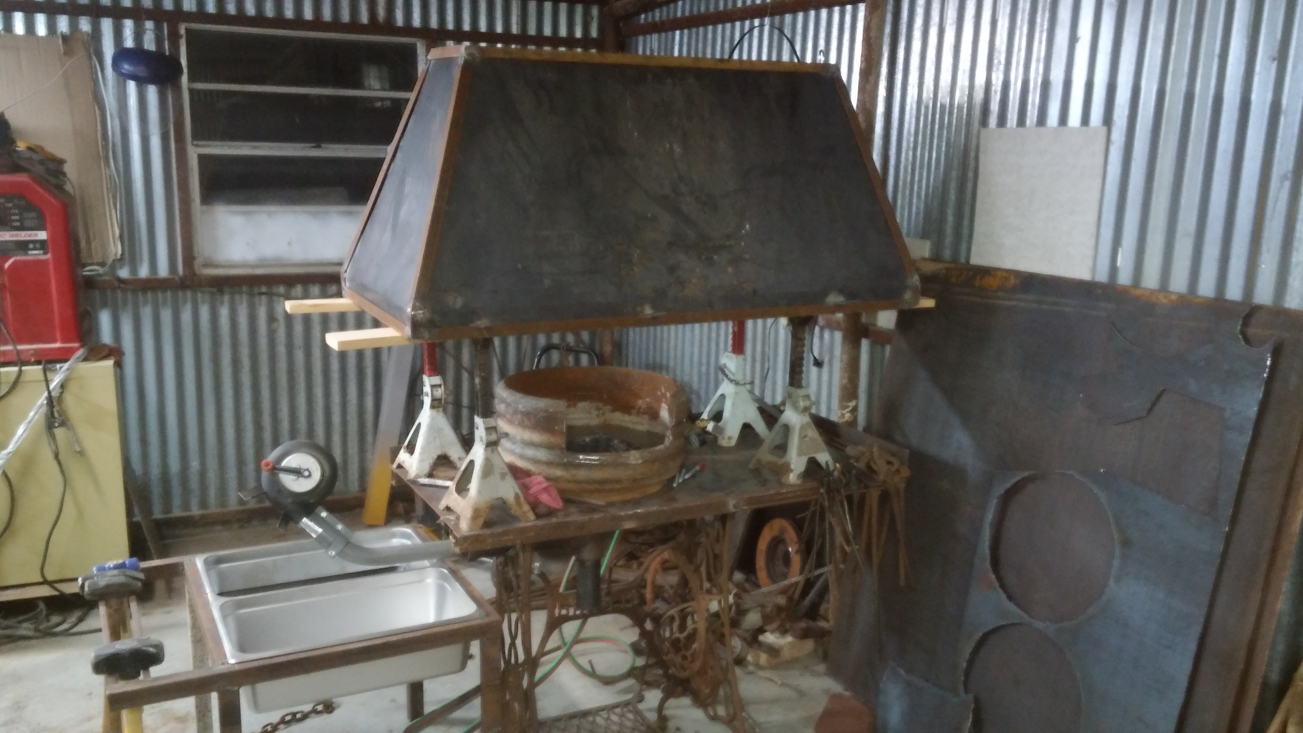

Rebel @ Black Sheep Forge Posted July 5, 2016 Share Posted July 5, 2016 I am currently fitting out my small shop. Its in 1\3 of a 24'x36' tin building with concrete floor. Other 2/3 is my wood shop. I have hand built all I can and am now down to attaching a chimney to the hand built forge hood. It will vent straight up. I wanted to bend some 18g sheet in a hex column but its looking like I may be purchasing 10" duct. I'm thinking one section of "black" pipe then galvanized rest of the way up. Quote Link to comment Share on other sites More sharing options...
Frosty Posted July 6, 2016 Share Posted July 6, 2016 Welcome aboard, glad to have you. If you'll put your general location in the header you might be surprised how many of the Iforge gang live within visiting distance. Depends on how long a section is but at least 36" and you'll be fine going with galvy stove pipe afterwards. Please tell me you aren't going to use that brake drum for a fire pot. Semi drums make TERRIBLE fire pots even if you're planning of forging things like anchor chain they're just too large and deep they're fuel hogs for the work they'll do. Even a 1500 pickup truck brake drum is a little on the large side, front disk rotors are a lot more popular amongst the guys using brake parts for fire pots. From what I see of your shop I wouldn't use a brake drum on a bet. You have a buzz box and a torch so unless you don't have a ruler and soap stone you don't have an excuse for not making a GOOD fire pot. Check out the solid fuel forge section here and find out what folk like and why. If the new platform has wiped out the existing plans, drawings, photos, etc. someone will be more than happy to post them again I'm sure. Do you have a blower to go with that treadle under the forge table? That could be a bit of coolness worth tinkering together. Not that a foot treadle forge blower is very practical but it'd sure look cool. Oh heck hook it to a grind stone or wire wheel. Hmmmm. Frosty The Lucky. Quote Link to comment Share on other sites More sharing options...

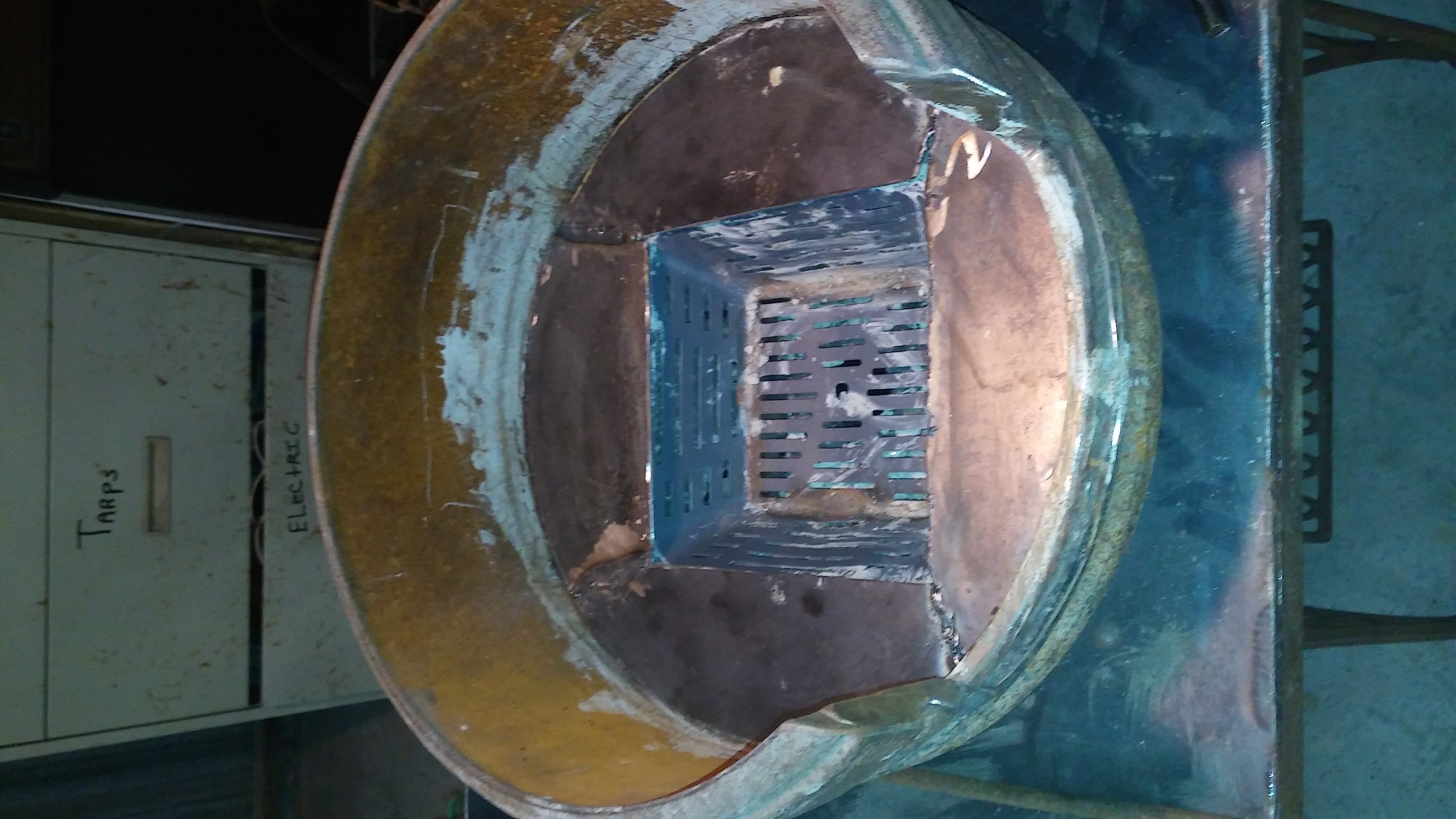

Rebel @ Black Sheep Forge Posted July 6, 2016 Share Posted July 6, 2016 This is my fire pot. I changed designs several times. After I get more fire time under my belt I will be bricking up my next forge. Baby steps...lol. I get way too excited bout fulfilling something I have wanted to do for years! Quote Link to comment Share on other sites More sharing options...
ThomasPowers Posted July 6, 2016 Share Posted July 6, 2016 That's a removable piece opposite the front opening so you can work long pieces? Quote Link to comment Share on other sites More sharing options...
Rebel @ Black Sheep Forge Posted July 6, 2016 Share Posted July 6, 2016 I am in the process of cutting a "pass thru" opposite the main opening yes. Quote Link to comment Share on other sites More sharing options...
Frosty Posted July 6, 2016 Share Posted July 6, 2016 The air grate is WAY over sized in fact the basket you made or are using for the air grate is actually a lot more practical size for the fire pot itself. for most uses an air grate around 3" dia. is more than enough and a lot of guys do large work with a 2" air grate. A brake rotor with the disk flat on the table and the hub inset. Then it's easy to make a simple bolt flange with the tuyere attached. I used 3" exhaust pipe for the vertical and 2" for the horizontal air supply. The ash dump is just an exhaust flap cap clamped to the bottom with a little extension to the counter weight to keep it closed but easily opened with anything that'll reach. Just flip the counter weight up and the dump is open. It also is an excellent escape valve if coal gas explodes in the tuyere. That sounds worse than it usually is, it's usually a pop but on occasion can blow coals out of the fire. I think everybody over builds their first couple pieces of equipment. My first coal forge is 3' x 4' but I'd used a fire pot with another smith who was sort of a . . . Ricardo and I tried a "Duck's Nest" in reaction and discovered I really prefer a duck's nest. My large forge has a salvaged brick table with about a 5" sq. hole over the air grate and I make the fire's shape with fire brick around the air grate. I made my air grate out of 3/8" plate with a pattern of 25-30, 5/16" holes bordered by the 3" dia. tuyere pipe. In no time I'd blocked all but 6-8 holes with rivets. Even then it was generally more air than I usually needed and I kept my blower mostly closed with a pivoting choke plate. It is really too easy to build WAY more than you'll ever use, been there done that, still do in fact. I still have a couple of my first forges taking up space, my original propane forge and my first couple coal forges are still around. Heck I don't burn coal it's too hard to come by anything that isn't more coal shale than useful in a forge. Anywho, having a couple few . . . call them prototyes in corners or under benches is a fine blacksmith tradition. Welcome to the club. Frosty The Lucky. Quote Link to comment Share on other sites More sharing options...

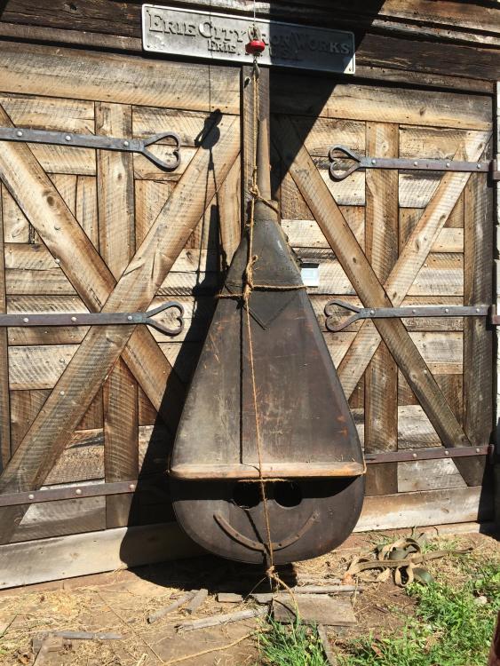

David R. Posted November 25, 2016 Share Posted November 25, 2016 Long awaited blacksmith shop under construction. Picked up lumber for sheathing from mill Wednesday. My plan is to restore the antique bellows and mount overhead to save floor space. Quote Link to comment Share on other sites More sharing options...

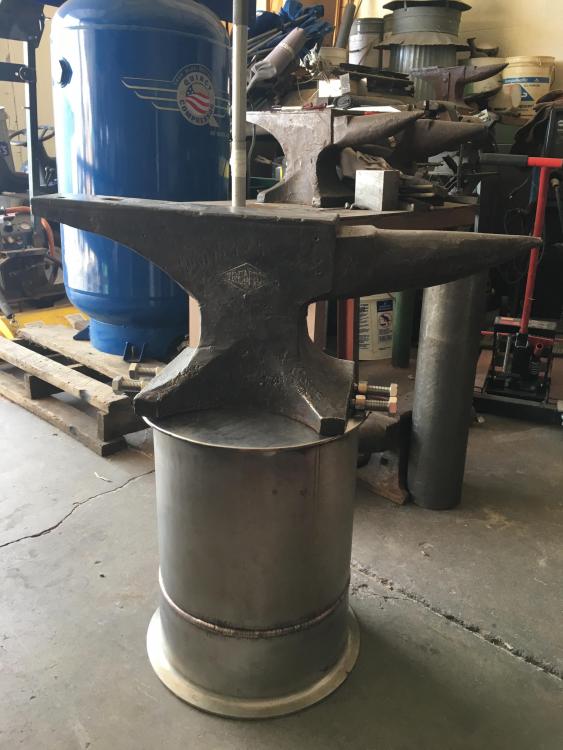

Hammerfall Posted February 28, 2017 Share Posted February 28, 2017 Still putting things together. Quote Link to comment Share on other sites More sharing options...
