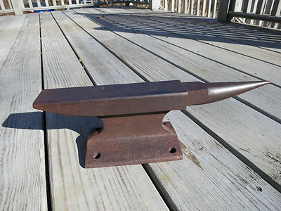

Frozenforge Posted January 8, 2016 Share Posted January 8, 2016 Your getting there. Here is a pic of the best looking RR track I've ever seen. They put alot of effort into that one! Link to comment Share on other sites More sharing options...
ausfire Posted January 8, 2016 Share Posted January 8, 2016 That's a work of art! The horn looks machined ... very precise. Link to comment Share on other sites More sharing options...
