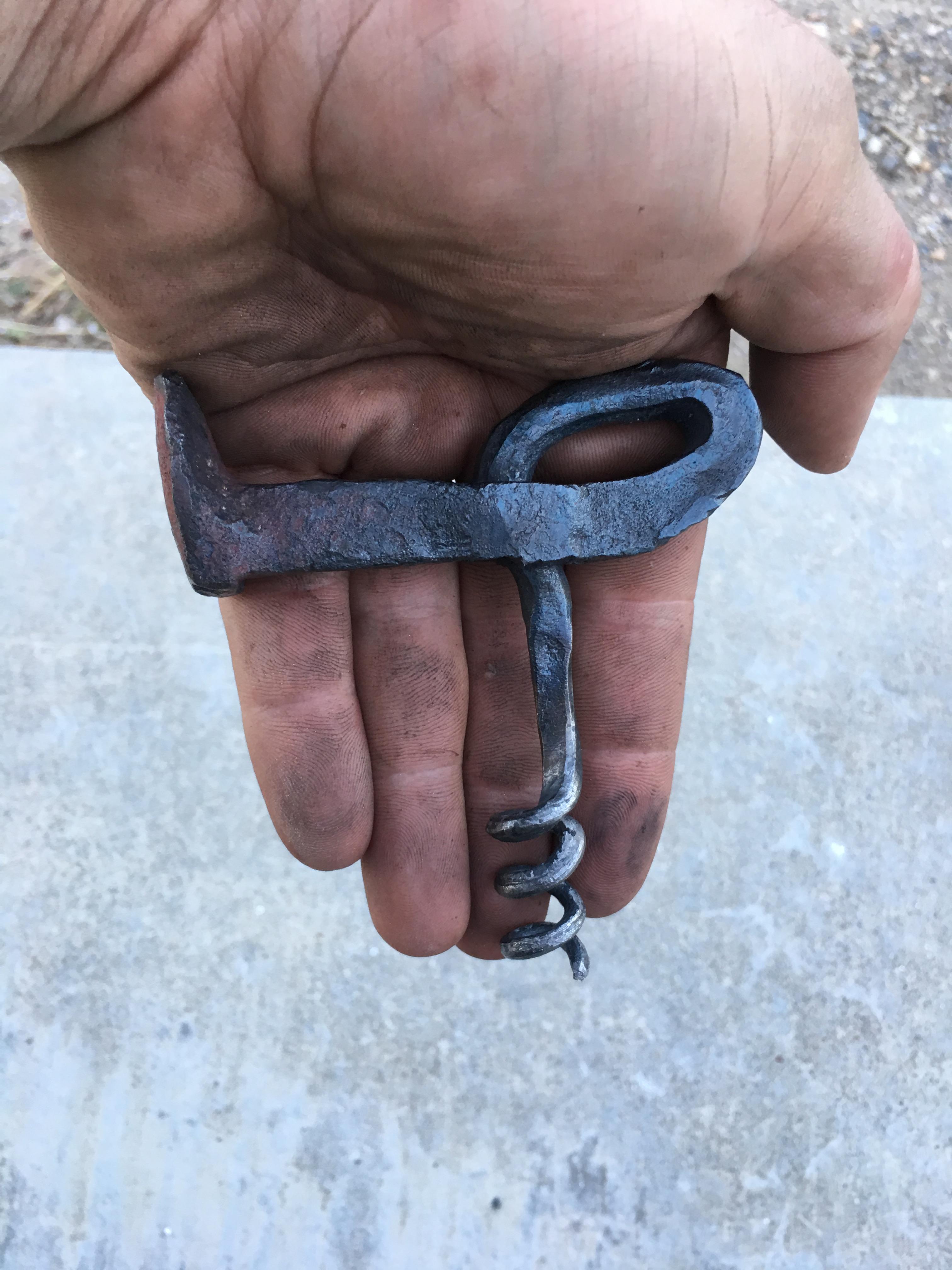

I did water quench it just for good measure. Aus It is a pity. I think it will be sturdy enough not hardened. I wouldn't go much thinner than an 1/8 inch round on the screw. I will let you know if we run into any problems as we use it. Rockstar, That's a good idea on the twists. its not the most comfortable right now so I might do that with this one.

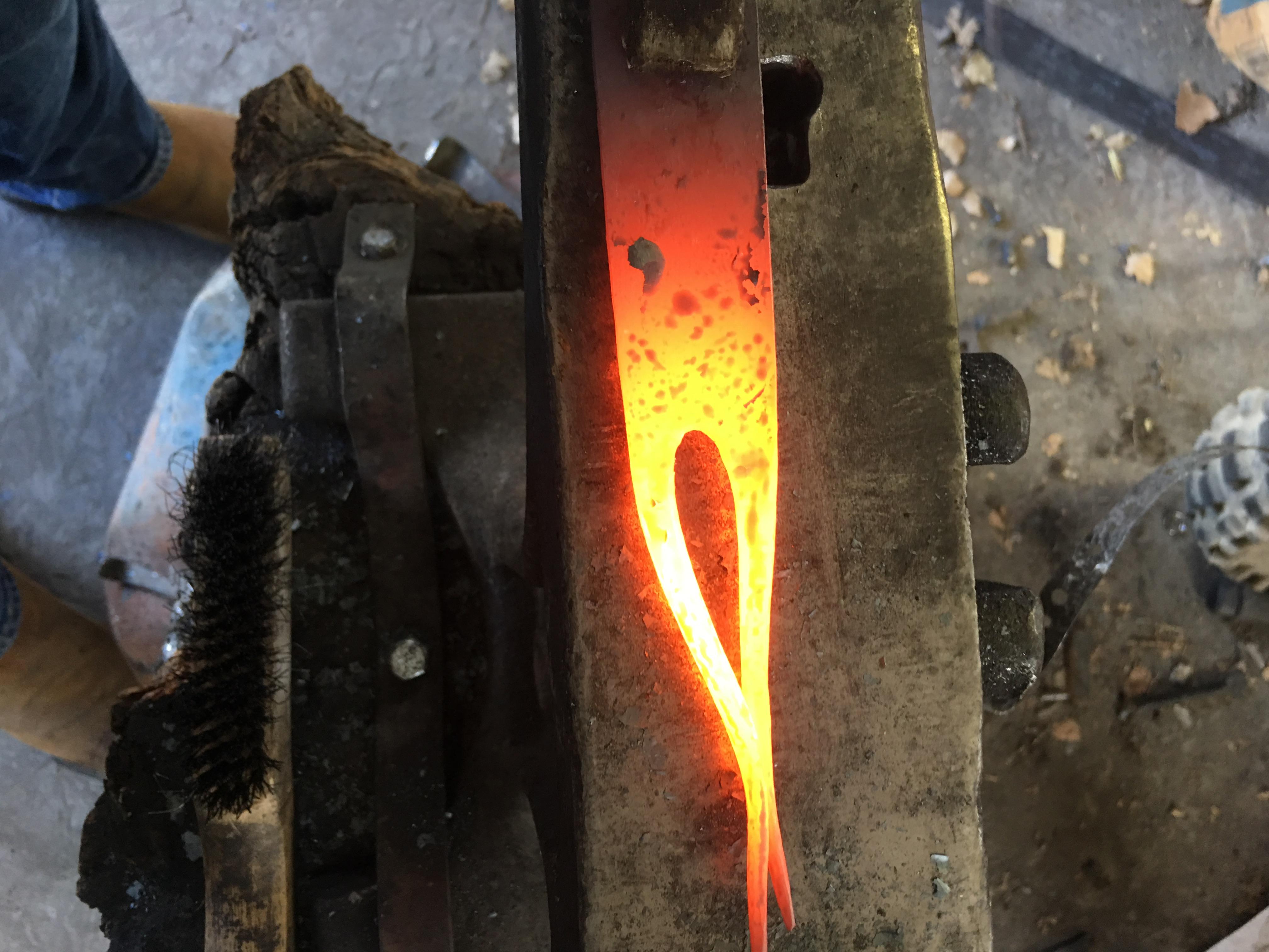

Made this cork screw out of a railroad spike. I used Mark Aspery’s pass through technique. This is my first go and it’s pretty rough. I will definitely be making more.

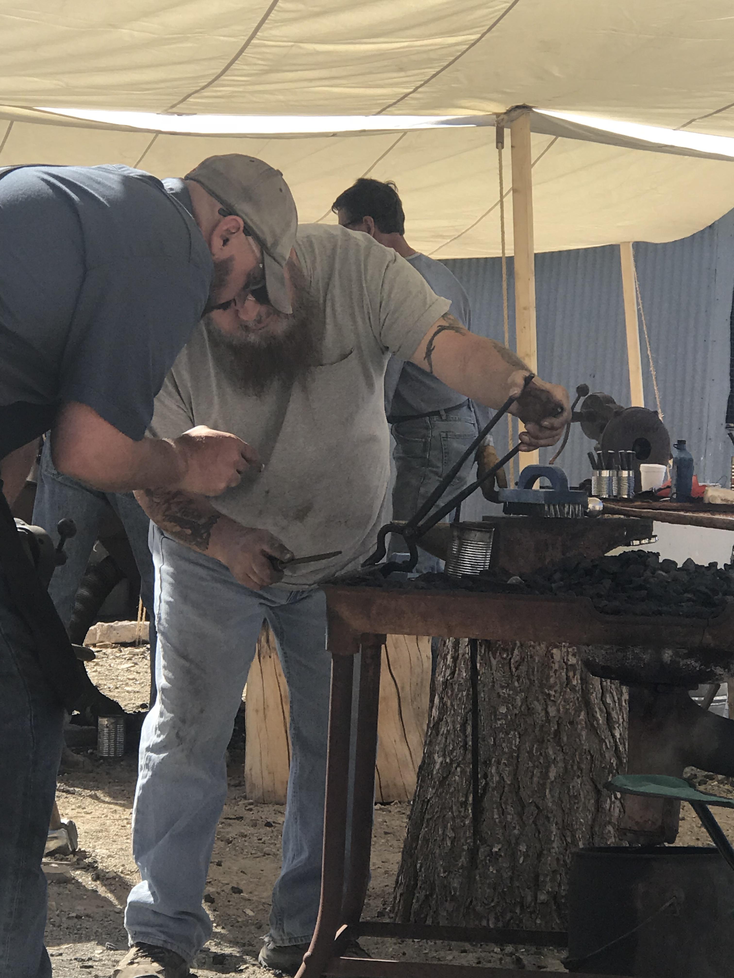

I’m glad to finally see this. I recently have been doing demonstrations and helping teach beginner classes at the Historical Tonopah Mining park.

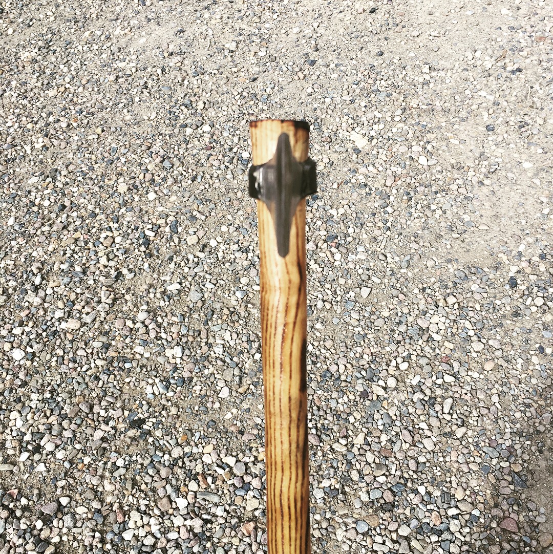

An axe and herb chopper

Thanks Flatliner, I took it out in the mountains the other day and chopped some fire wood. then gave it to the boys and let them put it through its paces. Did some throwing and ice chopping. it did well still holding the edge well.

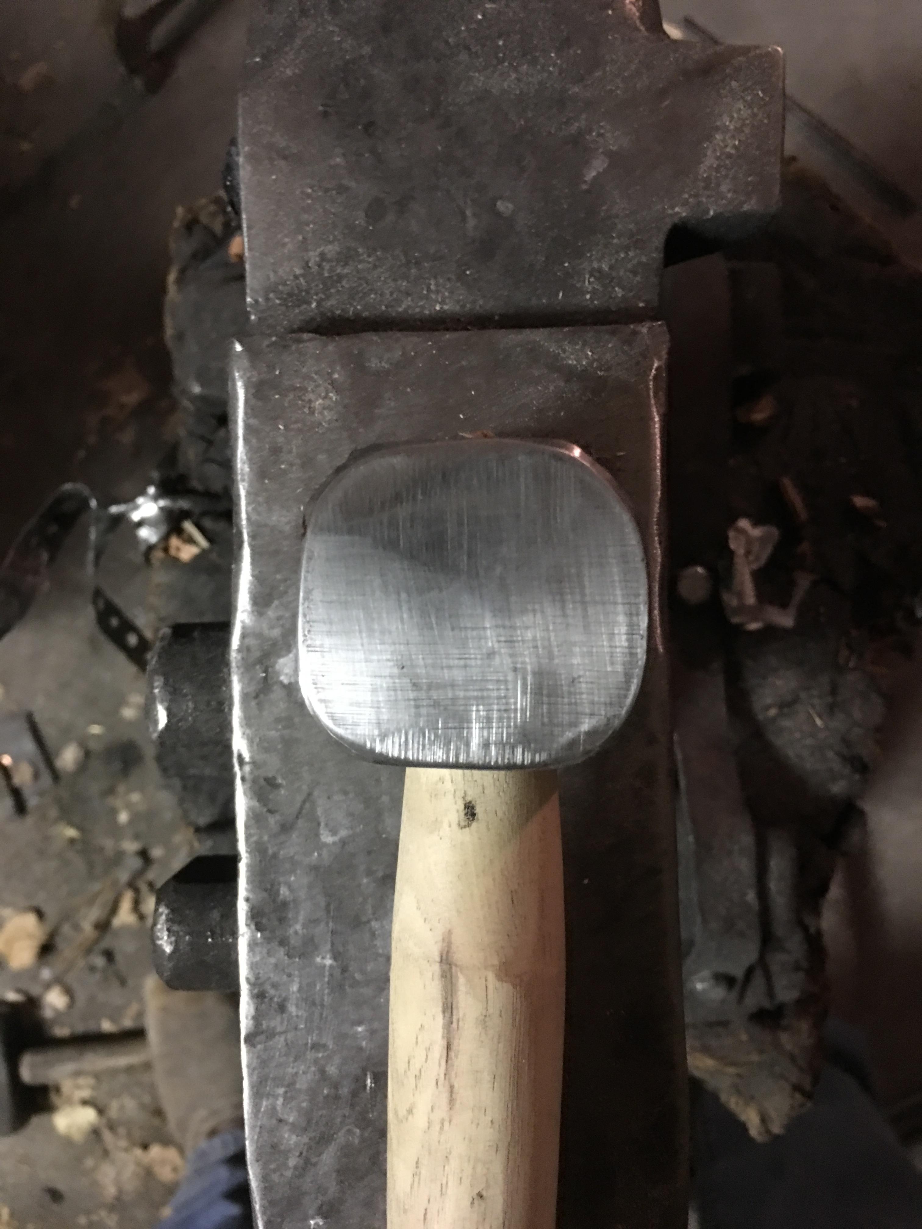

I made my first rounding hammer. I made it from a worn out loader bucket pin. 4140. Water quenched faces. No cracks. Drew the temper with the drift I made. Feels really good to finally get it done. It’s always been my real blacksmith project. Need a tool/make a tool.

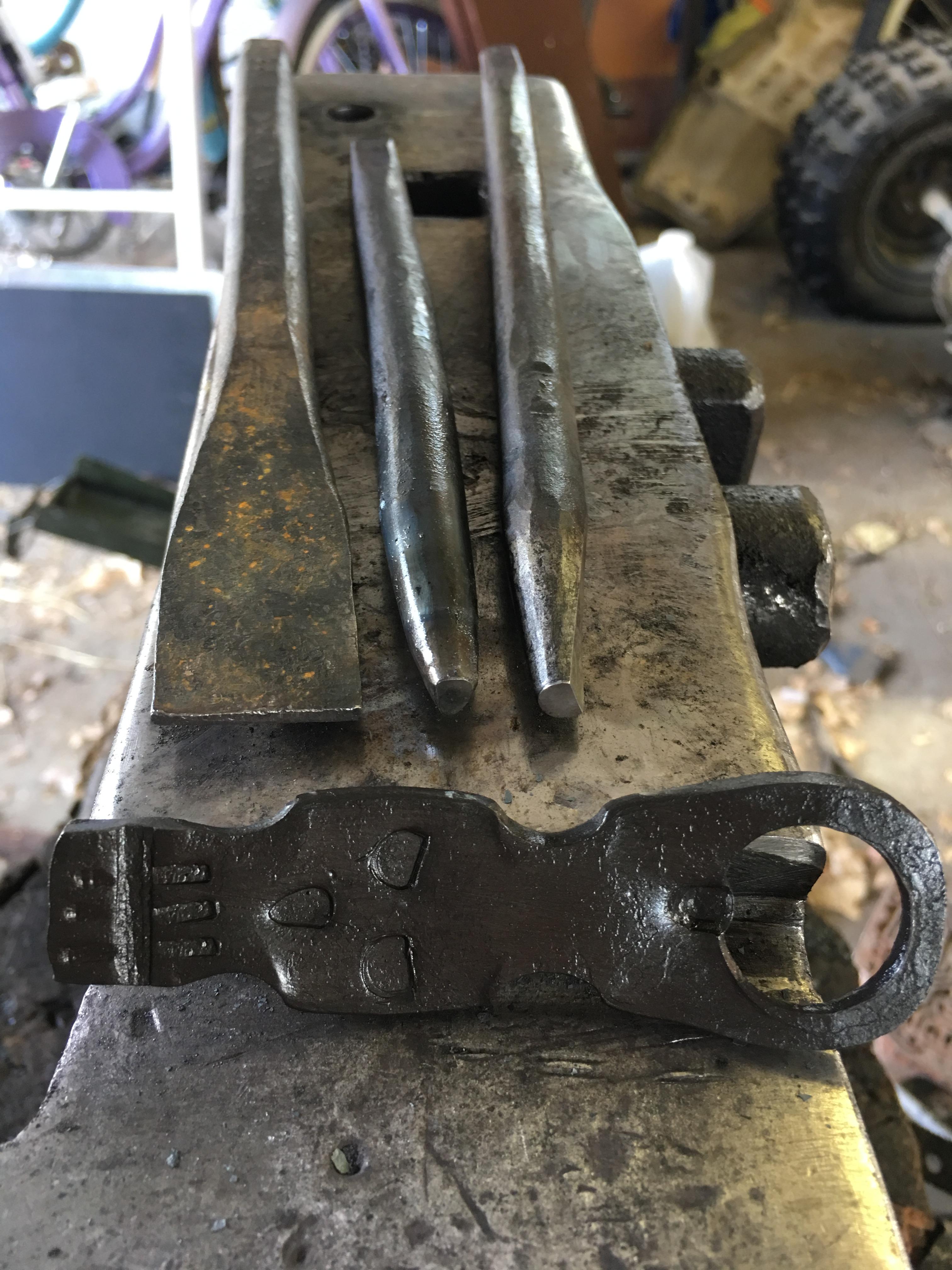

I made this spring fuller out of a scrap car spring I found. It amazing how much more I have running through my head now that I have one. This little owl shaped opener is the first thing I made with it.

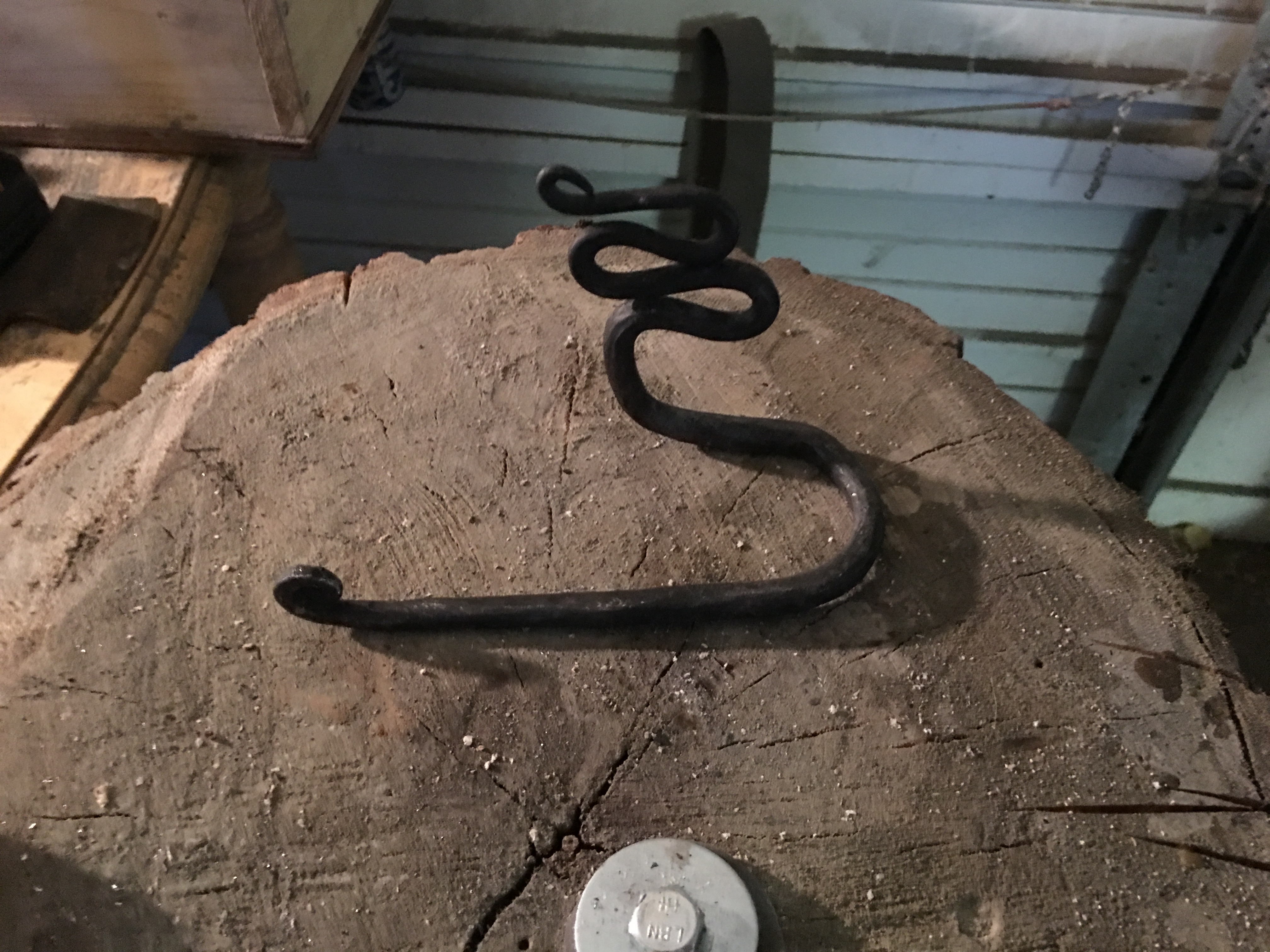

Getting some valentines stuff going. Also did a toilet paper holder. The little B came to hang out too. -
