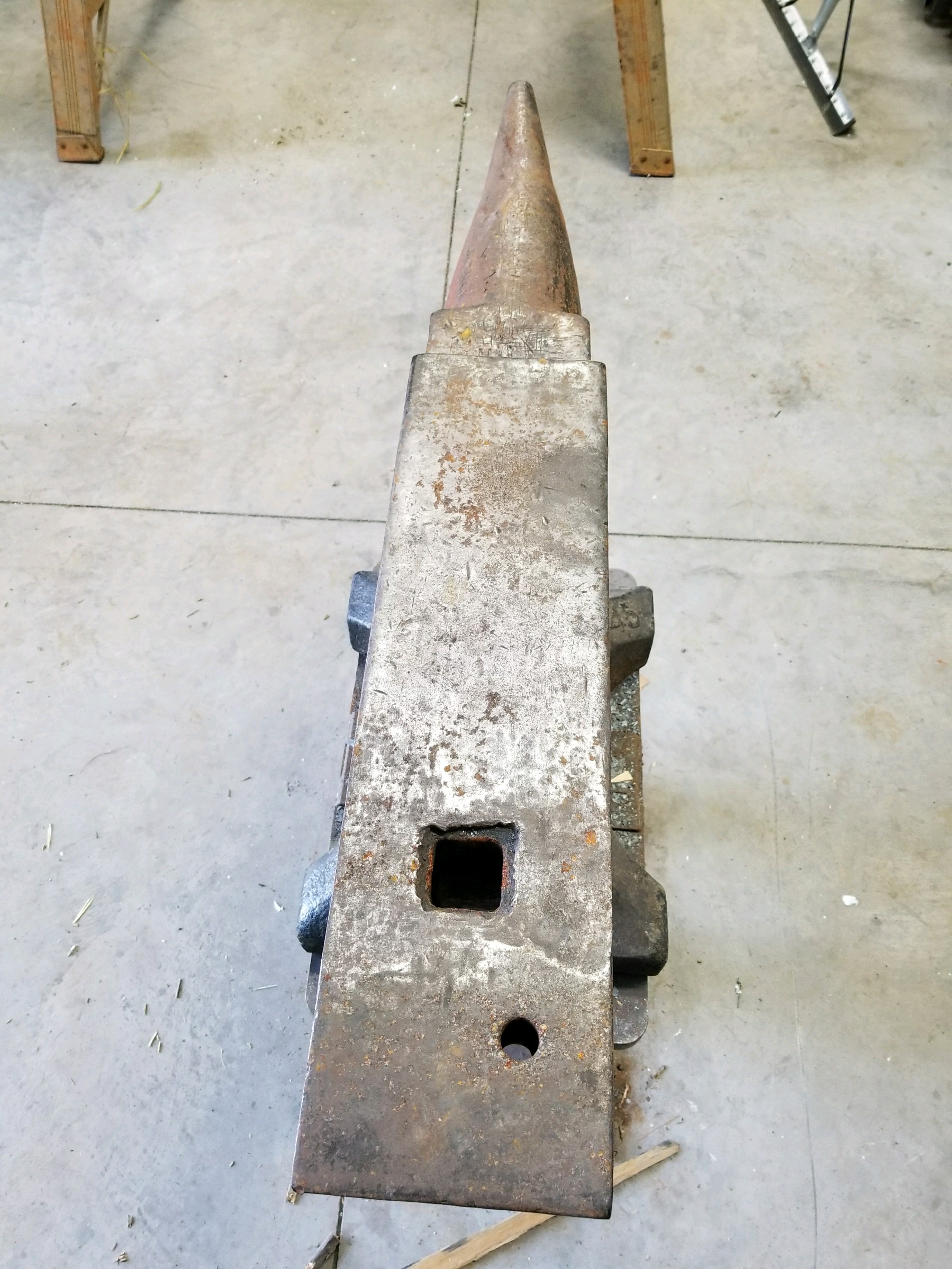

I pondered this earlier, and even mocked up a piece of 1-1/2 “ tubing flaring out the end. Too big for the hole but a good exercise in upsetting square tube. It measures to be like a 1 3/8”+ hardy and according to aia should be 1-3/8”. So best sized tubing i can get from my supplier is 1-1/4” with 11ga which leaves me a with 1” hardy. My next thought was how to fasten/secure the 1-1/4” tube in a 1-3/8” hole. I guess i could shim the sides and flare the bottom to lock it in. Or just leave it loose. Anyway just throwing out ideas. Thanks for the thought thanks i may just square up those hardy edges and round them slightly for looks and make a removable sleeve, because ive came to realize, i think i am just trying to fix it for looks.
Thanks for your thoughts guys.. ive cleaned it up and lightly flattened the high parts on the top. Im still pondering on the hardy. And still need to slightly dress the edges
Im not too sure about that 3/4”. I can see how it looks that way from the side. But the failed fishers ive seen were closer to 1/4”. their 1887 patent drawings show this thickened edge and thinner face. And yes i would plan on jumping the welds a bit.
That urge is powerful! I agree that the damage looks like a failed weld more than edge chipping, in how its uniform in appearance. But i know nothing of its past use, which it saw a lot of, other thant it came from the amarican bridge co. The shaft of the hardy is perfectly fine I tend to make my hardy tooling by tapering and upsetting for the tool base. That wont work here as is, I can make them on the swage block for use on this anvil.
I just wrestled this beast to the shop. Its a 1914 fisher 450 lb. there is a good amount of damage to the hardy edges at the top. My first instinct is to repair the edges. But ive also considered just making wider hardy tooling im my swage so it will rest on the top ie “span” over the missing edges. My repair procedure is to clean the area. Preheat with a big propane burner to 400F. Then nickle weld a base layer on the cast. Then clean and hard facing rod to build up the edge. Finally clean/dress the edges Ive repaired several wroght iron anvil edges and feel very confident in that area and Ive successfully repaired lots of simple cast iron gears and blocks etc. but the combination of that coupled with the size cause “It wont fit in my preheat oven” then hardfacing the top layer. Then once its done burry it in vermiculite. Then finally three days later when its cool i have to clean up the welded edges inside of the hardy. Lots of steps theres also two or three 1/4” x 1/4” wounds in the middle of the face id hardface weld while its hot. the anvil is very usable as is, with 90% rebound all over the base and about 50-70% rebound when moving on the heel.
