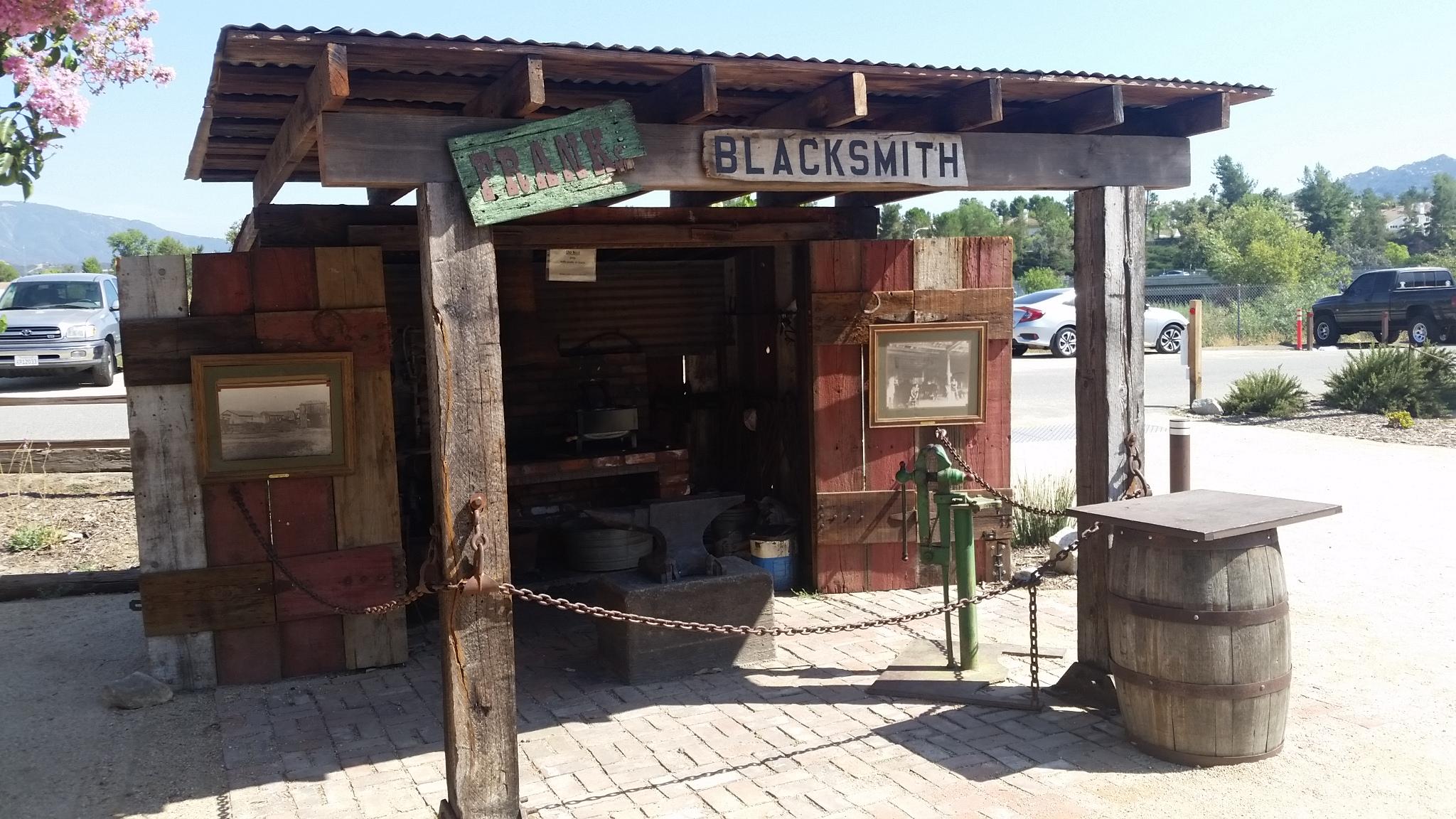

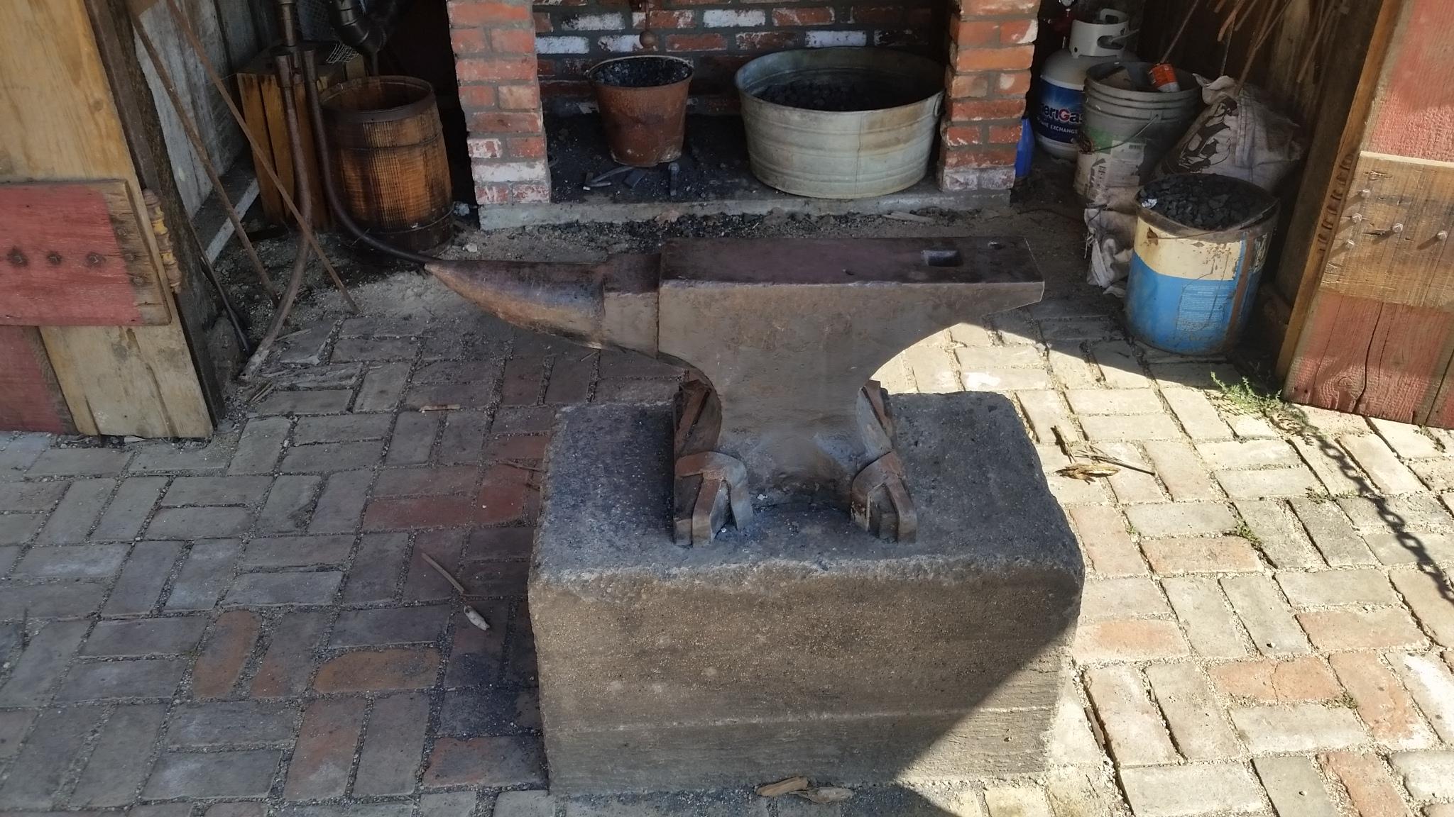

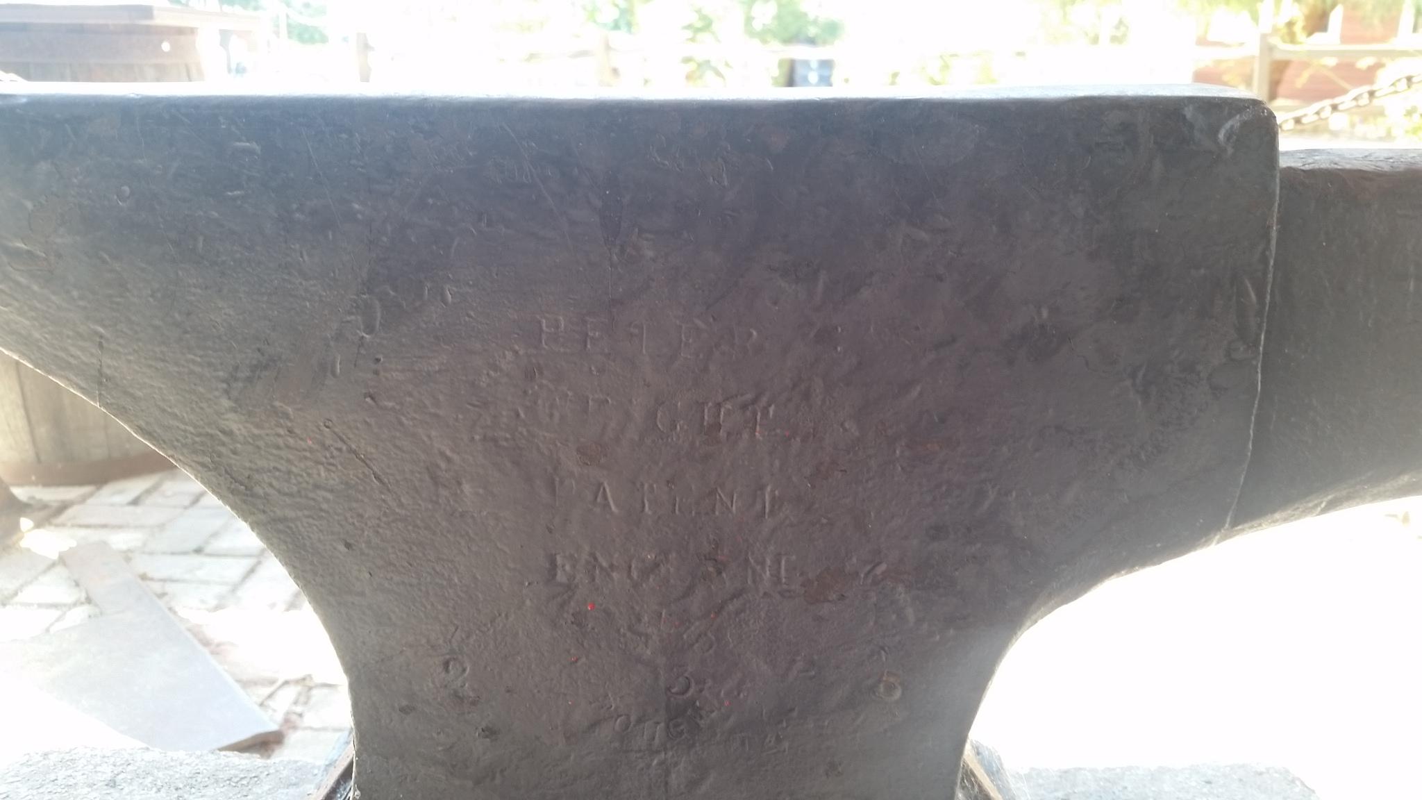

Was out walking on Sunday and came across small layout of an old western ranch, The Vale Ranch, not too far from my land. Took a few pictures but was both surprised and happy to find a good size Peter Wright sitting in the Smithy, had the "England" in the side markings and if I have read correctly on this site that would mean after 1910. Also weight markings were 2 - 3 - either 5 or 25 = (2 X 112) + (3 X 28) + 5 = 313 or 333 lbs. biggin ! Here are a couple of pictures: Demos every Tuesday... Guess where I will be on Tuesday next ! The Smithy Post Vice with 50's era Fordson Tractor in the back ground ! I think the propane forge is a little newer than the Smithy setup ! The Drill Press is nice ! The Peter Wright: Not in bad shape, didn't do a bounce test but it looked in good shape ! Climbed over the chain and got a close up ! Looks like 2 - 3 - 5 or 25, either 313 or 333 lbs, a good size Anvil !
