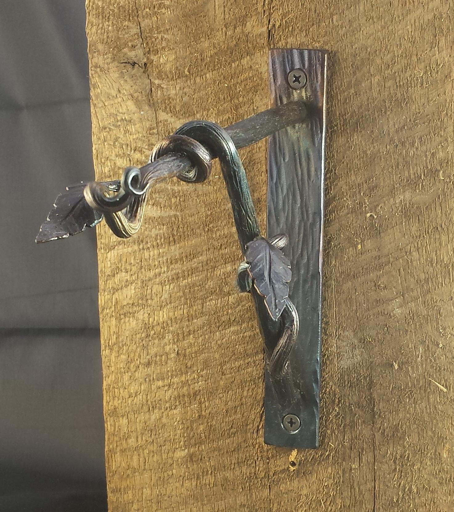

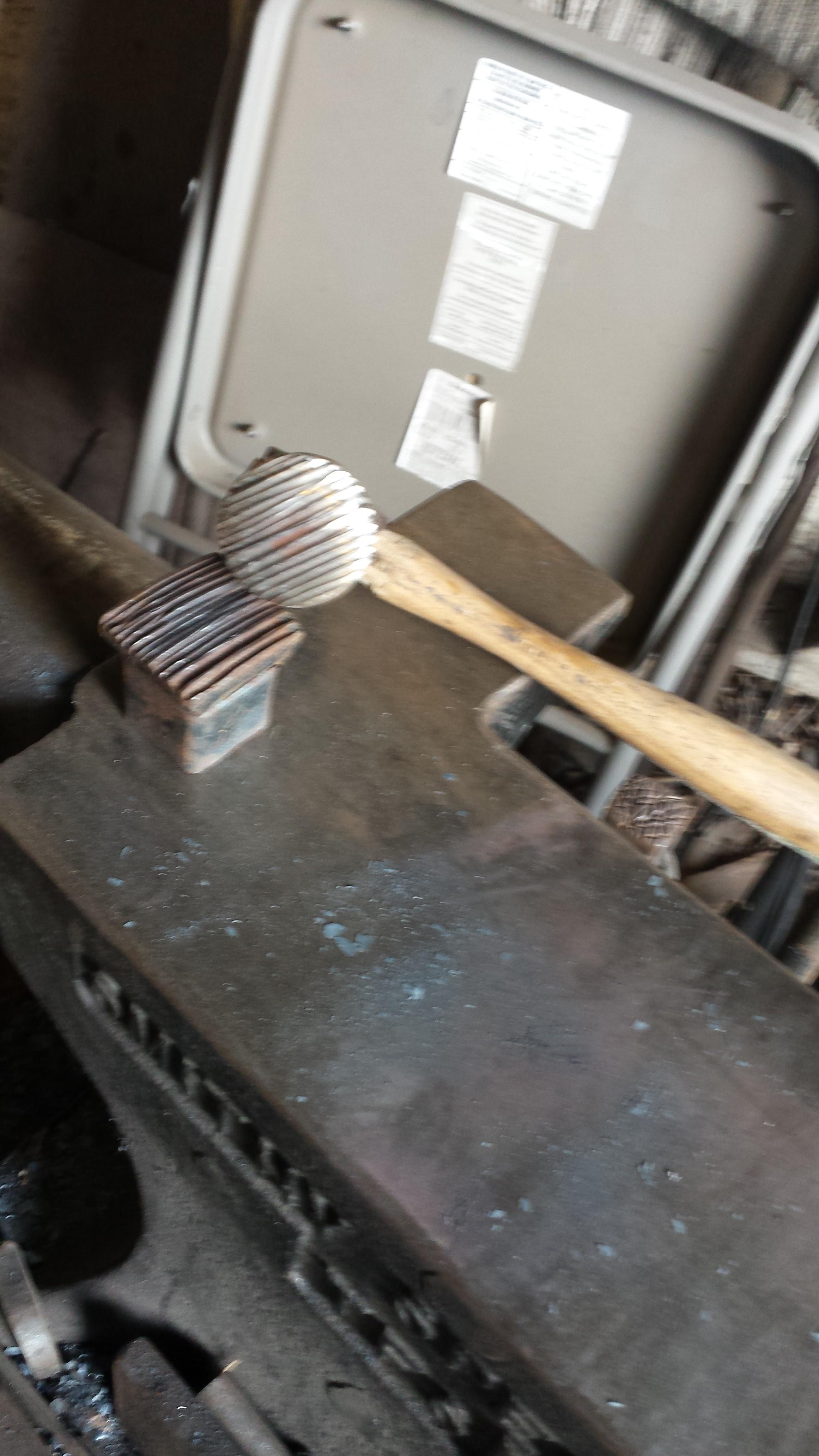

I don't know about a petrified wood texture, but to get a "viney"-"barky" texture, the two methods shown here already will certainly do the latter job. I opted to not use the spring fuller approach and instead modified a hammer as has been suggested. You also need to make a matching bottom swage. This is what I use: Note that the lines cut into the face of the hammer are at a 45 degree angle compared to the axis of the hammer. This is to allow you to make parallel texture grooves while holding the hammer out of line with the stock. I like hammer application because you can more easily introduce some randomness to the texture, making it more natural looking than if you use a spring swage. Video of discussion of and use of the pictured hammer/bottom tool. Texture application starts at about 18:54. Hope this helps.
