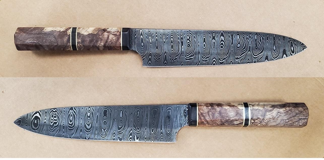

Kitchen knife... decided to keep this one for myself
