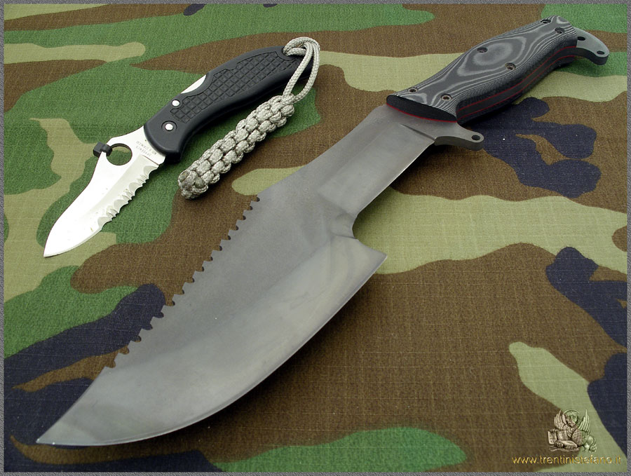

This is my interpretation of the Tracker: total lenght is 333mm (about 13") blade is 210mm (about 8") x 5mm; stainless steel MA5M pers.temp. to 54 Hrc, black from oven, with 100mm of wood teeth (15 teeth prepared on light bending) + cutting edge for cords prepared to the intersection of the two grinding. Handle is black micarta. Leather sheath (4,5mm).
