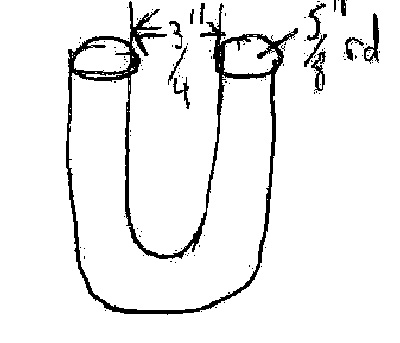

Let me use this example of forging a chain link out of 5/8 inch round mild steel. To make the bending fork, simply take a piece of 5/8” round, which is commensurate with the size of the stock being used for the chain link, and bend it into a U-shape. Make absolute sure that when you bend the bar into the U-shape, the tines are about ¾” apart. The reason for this small gap between the tines is control of the hot bend. Please see figure 1.
